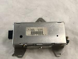

This amp will be right and up above the brake pedal can't give exact location. Because all I did was cut it out of my suburban harness before I put it in my crewcab.
And all data showed it powered the rear roof speakers

Today I just installed a jvc arsanal cd player , and after I hooked it up the rear door speakers didn't work and the speakers in the roof works and the thing under the seat is for my power seats so how am I suppose to get the rear speakers to work any one know how? Thanks in advance.
The ant wire for the after market radio needs to be connected to the pink wire in the truck side of the harness. The radio harness has a power antenna wire might be a blue wire. The pink wire is for the under dash amp to power the back door speakers.
