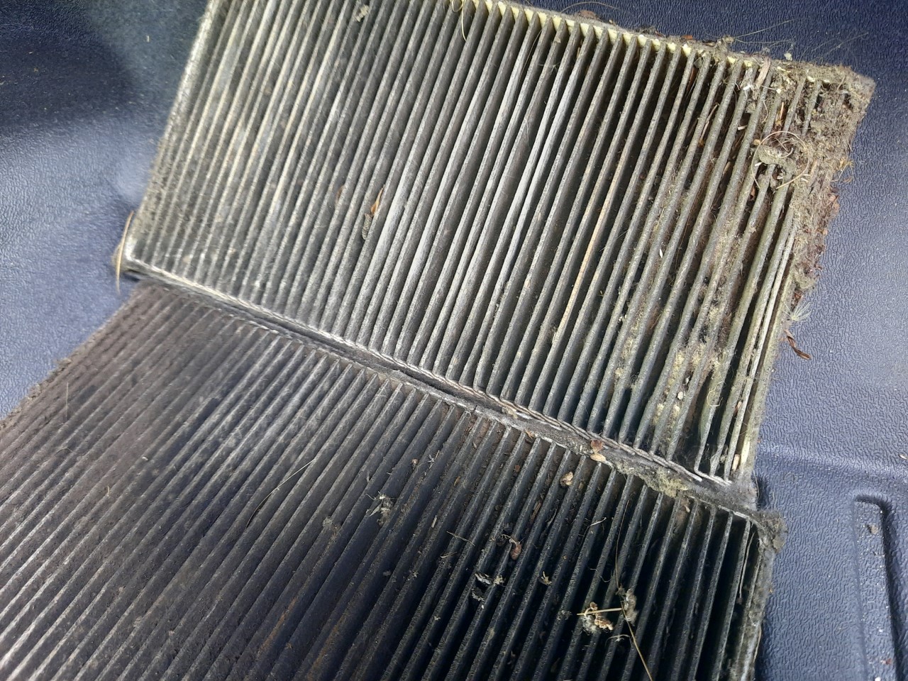

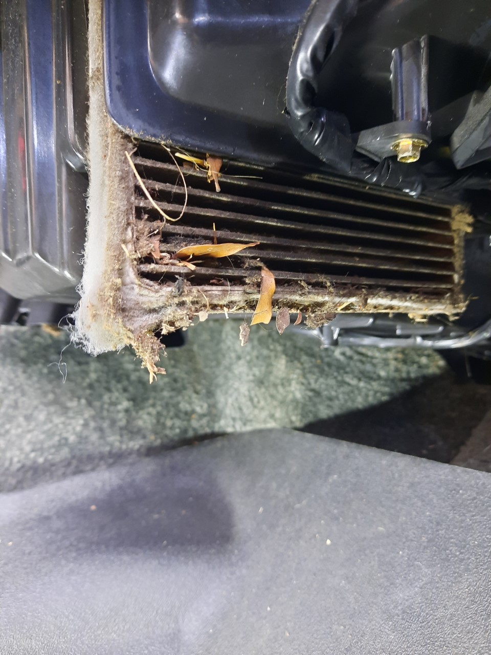

After replacing the Mode air motor. I wasn't happy with the amount of air coming from the vent. So I investigated the blend door motor to make sure it was working correctly. Works...So in doing so I discovered the cabin air filter box. Thought I would change it. Let's just say it might be the original one. So you all might want to take a look at yours if it been over a year since you replace it.
There are 2 of them in that box. The new one I order from Amazon came with 2 to a set. Much improvement in air flow.

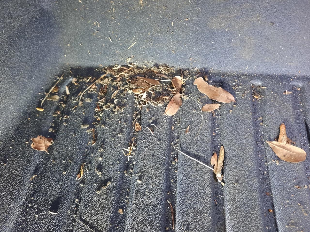

All the stuff that fell out. Also had to vacuum the box out.

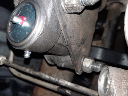

So I broke down and purchase a remain Steering Greer Box unit from Oriely's. I have to share this. I order it on Thursday and got it Friday morning!! I order it online and it had a 20% discount code at the top for home delivery. How can I go wrong...type in the code and yep got 20% off. I wasn't believing the next day delivery. But sure enough. BY 9am it was setting on my front porch. Oh and free delivery!! The whole unit was only $20 more then the PPL unit that was a piece of crap.
I took your advise and took my time. I even turned the shop stereo off. Just relax, thought about it and just got it done. Took me a little long than I thought it would. But it feels great that I fix it and I saved over $1500.
I will tell you this. If you should ever do this project. Make sure you get the replacement shaft nut and a new Pittman arm. That arm will not come off. I had to remove it from the old unit before turning it in for the core. That ever happen. I cut on it, heated it and even used the puller tool. Must have beat on it for an hour. It will not come off. Even the one from the PPL wouldn't come off. So thankfully I had ordered a new Pittman arm. I also replaced the Idler bracket and arm. So the whole front end is all new.
Man it made a huge difference. It steers so easy now. The play in the wheel is gone. It used to drift from side to side and was hard to handle on the road. I am so glad that is fix. I flush the power steering pump before running the new unit. If you haven't done a flush on your power steering fluid. You need to. I am also going to add a inline filter.

Old unit, New unit.
New idler. The old fluid. Was dark and burnt. This is supposed to be clear.
