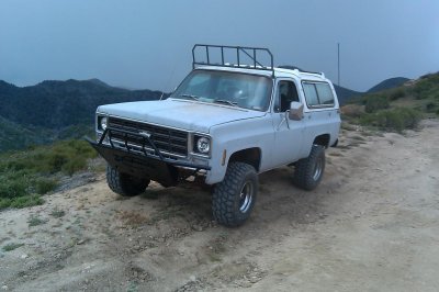

My new K5

Thanks bro, I love this truck I drive it more than my tahoe now, I did the interior up last weekend but ive been to lazy to take some pics

So Im pulling the motor and things have snowballed into a frame off resto, has anyone done a under body spray that they have had success with?
