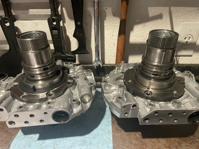

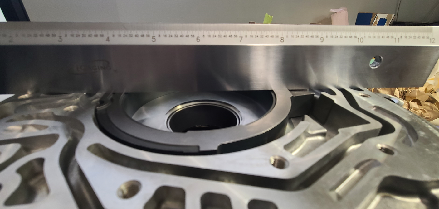

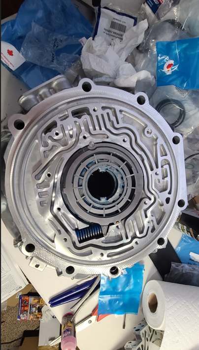

Reinforce the welds in your existing drum (or have a machine shop do so) and purchase the Sonnax 1-2-3-4 billet piston. Also, if you have an early 6L80 then your pump has a first design stator. You will want to swap to a 2nd design (mid-year 2009+) that uses the updated sealing ring set up (locking sealing rings and underlying support O-rings) to prevent slipping/flaring or other symptoms driven by inadequate apply circuit sealing (aka cross-leaks) between the pump and 3-5-R drum.
I swap in a 2nd design stator/pump cover assembly on all 6L80s that come in w/that first design stator. If your vehicle is pre-2010, chances are you have the first design. Make sure you have your pump body/bell housing machined as well. Rotor and slide should also be replaced at this point (your machinist can source them for you and machine everything to spec). Install Transgo's unbreakable pump ring kit with new vanes for added insurance.
First design is on the left, second design is on the right. Note the square notches machined into the sealing ring areas on the pump at right. The early (left pump) does not have these.
