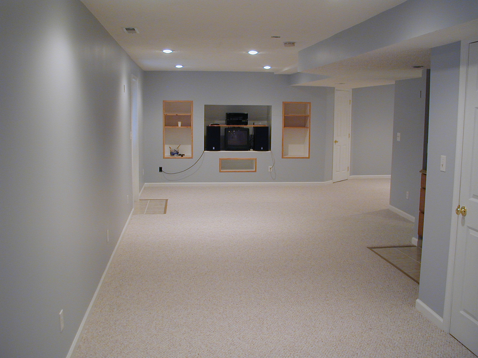

Finished the wet bar early Saturday about an hour before the carpet people arrived. Went with a very high quality padding and a very good quality berber (both great for basements). Quite happy with the job. Now furniture and video /audio equipment in the future. But first back to my engine build.
View attachment 401036View attachment 401037View attachment 401038View attachment 401039
Really, really impressive (and fast) work. Thanks for sharing.
25,508
49,036
Thank you - As far as the quickness, seemed longer. Taking time off from work opens up the day/early evening. Back to work tomorrow, I need to retire. I enjoyed that time off immensely.
Being retired definitely makes it easier time-wise for me. Now I work on stuff at my leisure instead of trying to do it after work and on weekends like I did 15 years ago when I bought my current house which was a fixer-upper. But getting up in age has its drawbacks. My back is my biggest issue. As far as most work, it’s no problem but working on stuff close to the ground gets to me. Like you, I am self-taught in construction- I learned mostly from a couple books and I did remodeling projects for my family when I was young. I turned that into a couple jobs in the industry throughout my life. I too started when I framed with a hammer, my grandpa and me did some stuff when I was a teenager and I remember it was a lot harder. I bought my own air guns as soon as I found out about them. You really did get that done quickly, and did a great job too. Congrats.
