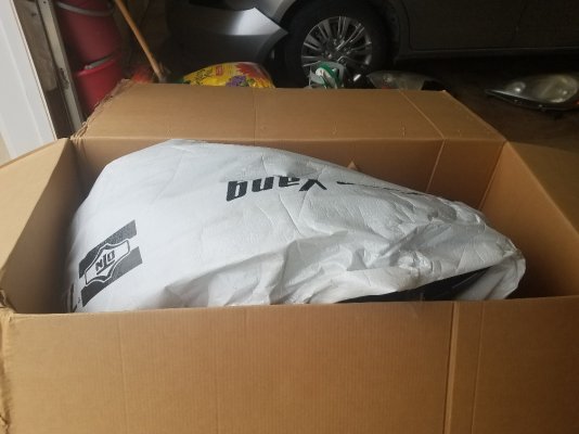

On a separate note, I'm also working on my son-in-law's 2009 Honda fit (what a tiny little truck - yes in Maryland it is considered a light duty truck - Ha Ha). He has some damage to his passenger side Headlight assembly and bumper cover. We ordered a new bumper cover and it arrived today. Get this - they folded it in half to fit in the shipping box. It's not useable - I guess I could try to reshape it with a heat gun but I shouldn't have to. It's getting sent back.

That's how it's done, at least last time I checked on one for a friend. There should be instructions on leaving it in a warm place, in the sun, etc., to straighten it out. Never bought one, but they're supposedly "shape-memory" plastic.
