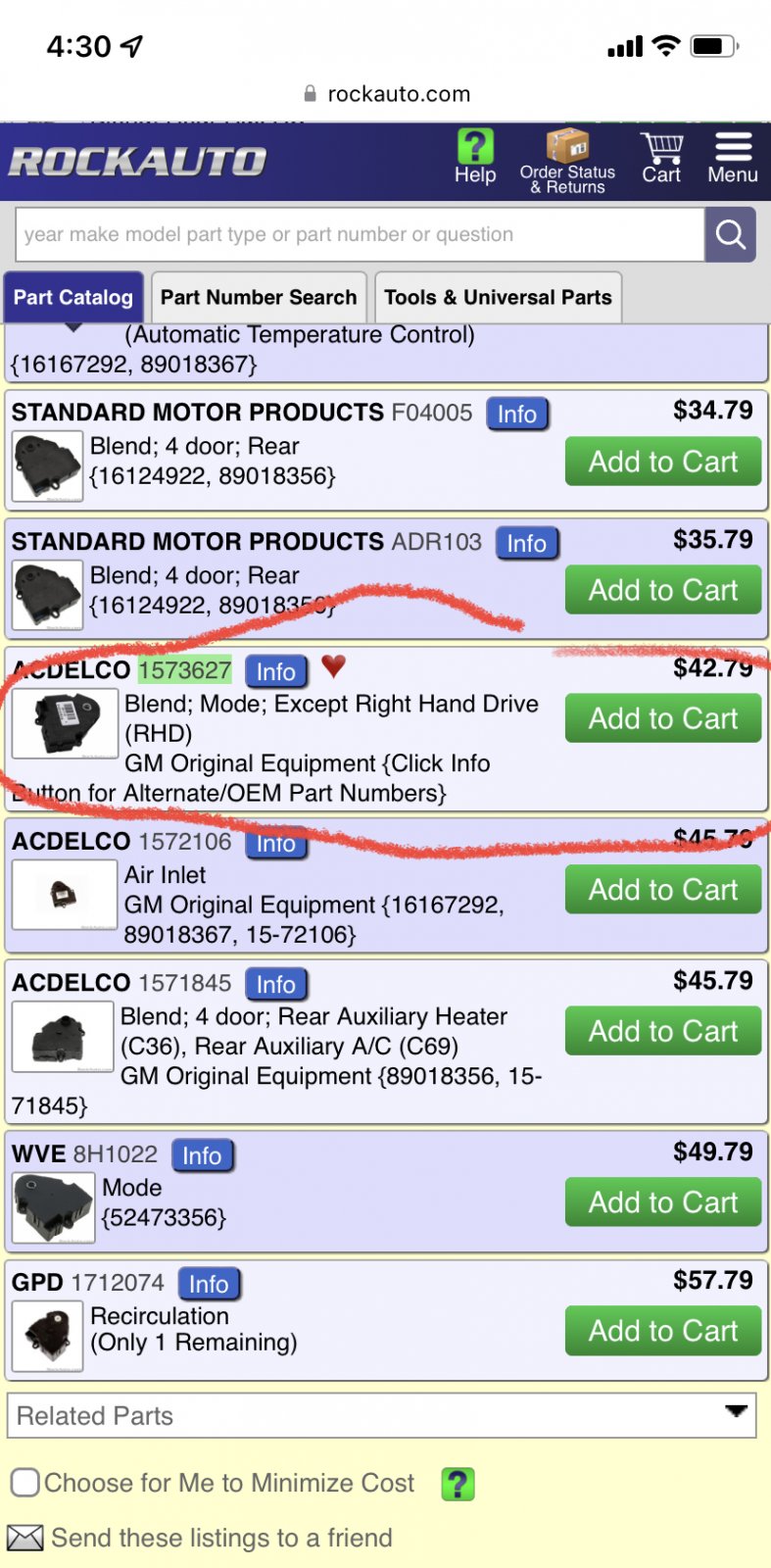

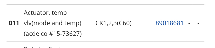

Mode and temperature (heater) use the same actuator. As mentioned above, see if it’s actually turning (there’s a notched silver position indicator dial on it) or if the connected linkage arms are intact.
Here’s the GM and Delco part number:
