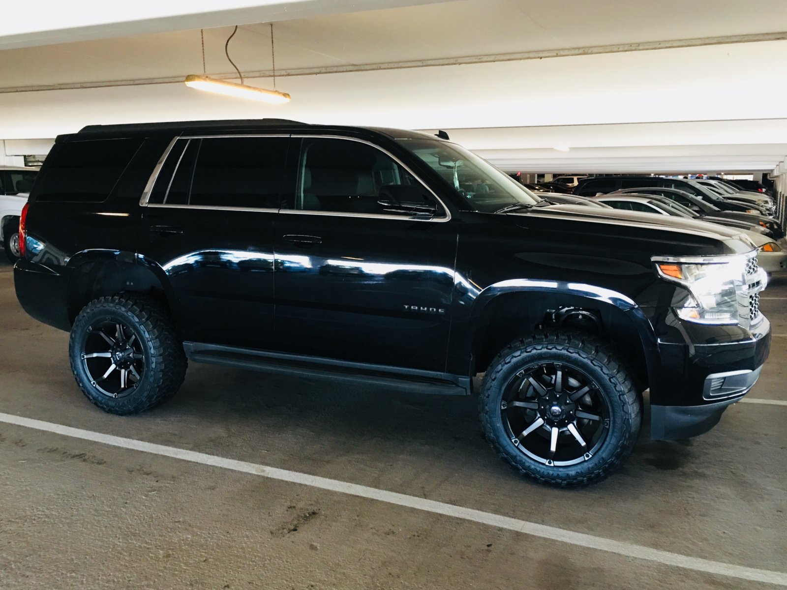

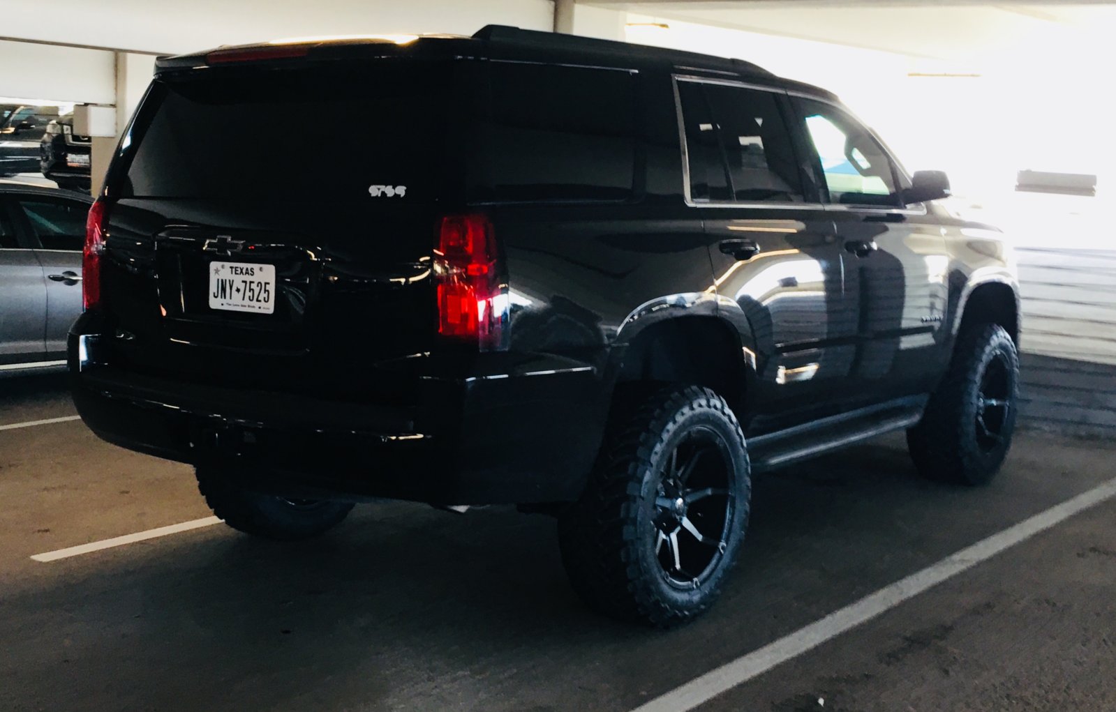

I was going to do 2.5/1.5 level but I ended up do 3.5 RC lift. Running 20x10-12 fuel calipers with 33x12.5. Absolutely no rubbing. Tires stick out about an inch and wheel wells are not stuffed at all.
View attachment 185768 View attachment 185769
You've got a great looking Tahoe - that's exactly the look I'm going for. Looking at RC's site though, it looks like they only make the 3.5 lift kit for a 2WD 2017 Tahoe - is yours 2WD or 4WD?
I have a 4x4 2015 - I made the desicion for the lift last minute at the shop and they had the RC lift in stock - I never caught the model number. I actually came there with my 2.5 level ready to install, but decided I wanted to avoid rubbing/trimming all together and run 20x10s - so RC lift it was. The car sits 6ft 8in high, so I’m still able to park in the garage and most parking garages.
