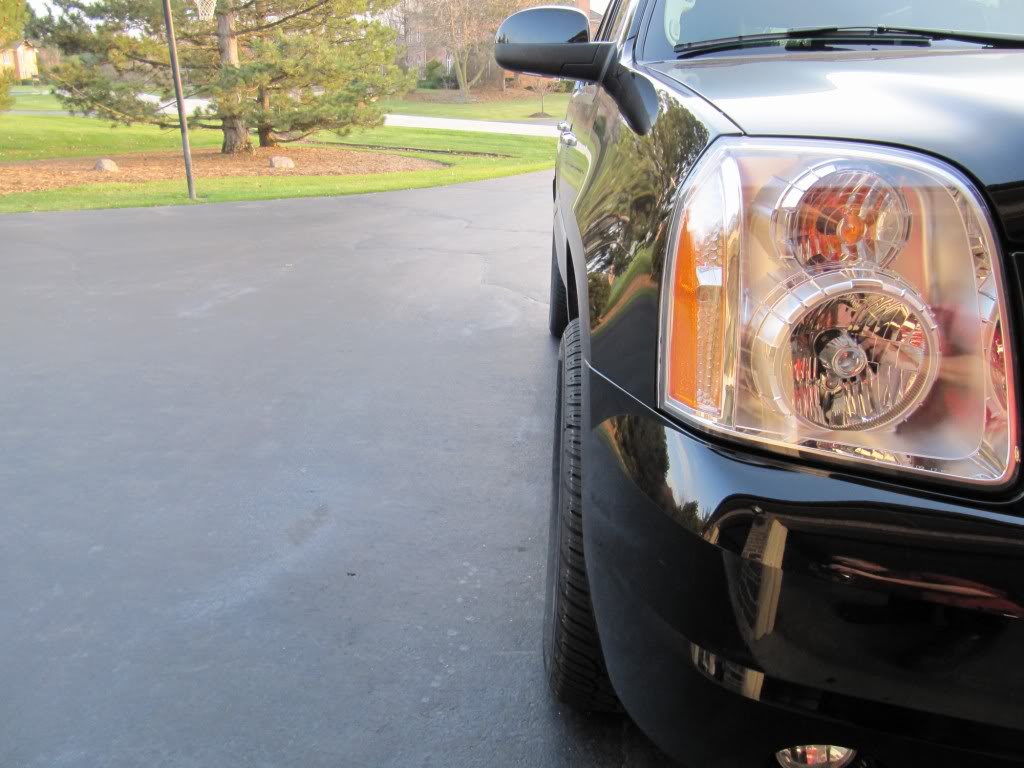

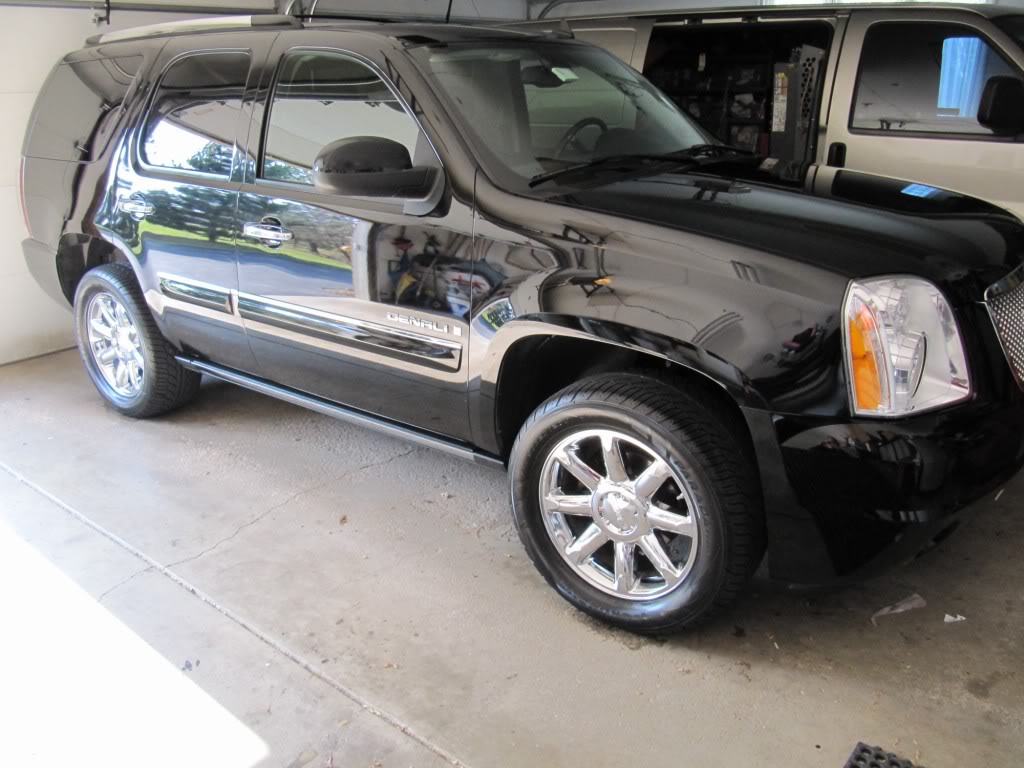

I took off the stock 275/55-20s and put in Yokohama Parada Spec-X 305/50-20s. It was the next size wider with the same diameter. When UPS brought them I was surprised how wide they were. I noticed a slight rub on the front inner fender at full lock, but no other issues yet.

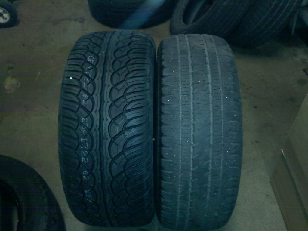

I have the same issue as I like the yoks but they seem to run small for the size. I saw a NNBS Hoe with the 275's and they just looked to small compared to the Bridgestones. I had the X's on my TBSS and was very happy with them, but they looked small compared to the Goodyears that came on it. I wanted to move up to the 275 but stuck with the stock size.
Now for the questions.
1. Can you tell me the sectioned width of the 305's mounted on the stock 20's? My stock 275's are tight in the back due to being lowered. I had to trim out the front of the wheel well plastic as they would rub on corners when I had a few people with me.
2. Did the shop give you any flack about the 305's being to big for the stock rims?
3. How much weight did it take to get them to balance?
Looks killer!

Yes the Yokohamas even read a little smaller if you compare specs side by side on Tirerack.com.
1) I tape measured the section width the best I could and it looks like 12". The spec says 12.4". It does seem to bulge slightly from a rim that probably should be 1" wider.
2)I mounted them myself, but a couple guys commented how big they were.
3)They balanced really nicely. A couple took less than 1 ounce per side. One needed 3 ounces. I used a Hunter Roadforce balancer and one was 8lbs, 2 were 11lbs and one was 14lbs, which is awesome for a tire this size.

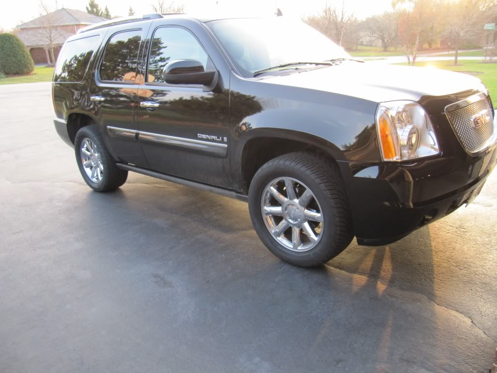

Here is a picture of how it usually looks. I am embarrassed of those dirty ones.

I really don't think I have room to lower it with the Pedders Sport II kit. 3" will definitely rub in the rear. It already has a slight rub when I go up a curb while turning. I guess it is the body roll.

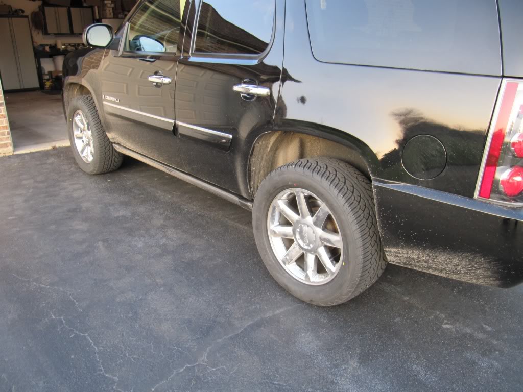

On mine, at least, there is a bulge in the plastic wheel well at the rear for the upper shock bolt. I also have a bulge in the front where the ride height sensor is. What part did you trim? Any pictures?

Forgive the dirt but it rained / snowed today. My concern is when the wheel is turned. The front tires are very close to the wheel well. I have never had them rub but there is not much room for more tire.
The front has room for 1 finger when the wheel is turned.
The rear has room for 2 fingers when the wheel is turned.

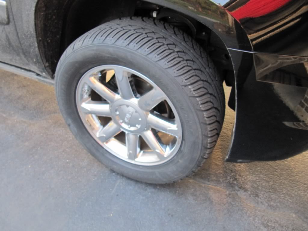

The front rubs ever so slightly when the wheels are at full lock, in which you would barley be moving. It isn't bad at all or concerning.
The rear looks like it will rub after lowered. Does your rear rub now? Here is a picture of the area I am concerned with.

The rear comment was directed to the rear of the front tire compared to the front of the front tire. It just seems very tight when you turn the wheel. The rear wheel well seems to have enough room. I will try to snap a pic Tuesday.
