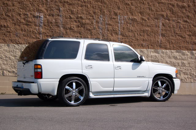

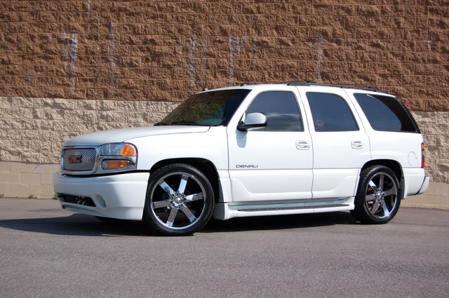

Spindles and 3" belltech coils will ride great. They have a kit that comes with shorter autoride links as well as shock extensions and shorter bumpstops. Here is a yukon denali with torsion keys (harder to align and rides worse than just spindles though they are substantially cheaper) and 3" belltech coils
