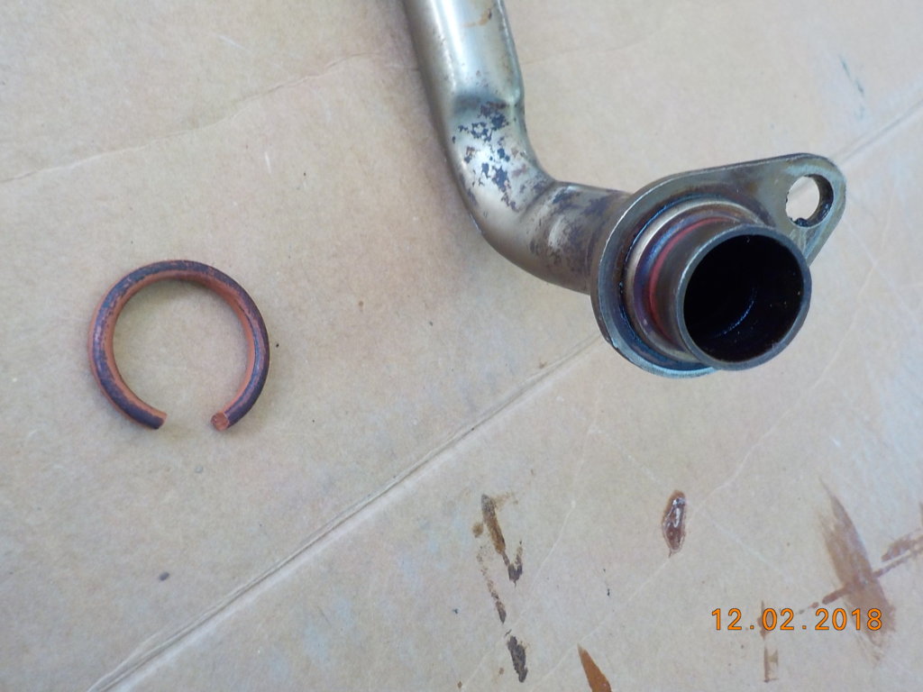

EDIT: this issue cropped back up again about a year later. Looks like the issue is fixed!
The culprit is a screen that sits between the oil sensor and the oil flow.
It gets gunked up over time which in turn leads to false readings.
Here's a pic of the screen that was removed.
Whether or not you disabled v4 mode, permanently deleted the v4 mode valvetrain stuff, there's a screen that clogs over time.
At some point, it clogs enough to mess with the oil pressure sensor's reading.
Clean or replace that screen, and the oil pressure sensor as well.
If that doesn't fix it, there's an Oil Pump O-Ring Seal that splits.
The oil pan needs to come off, which is likely more of a pain in the arse for AWD or 4WD vehicles.
