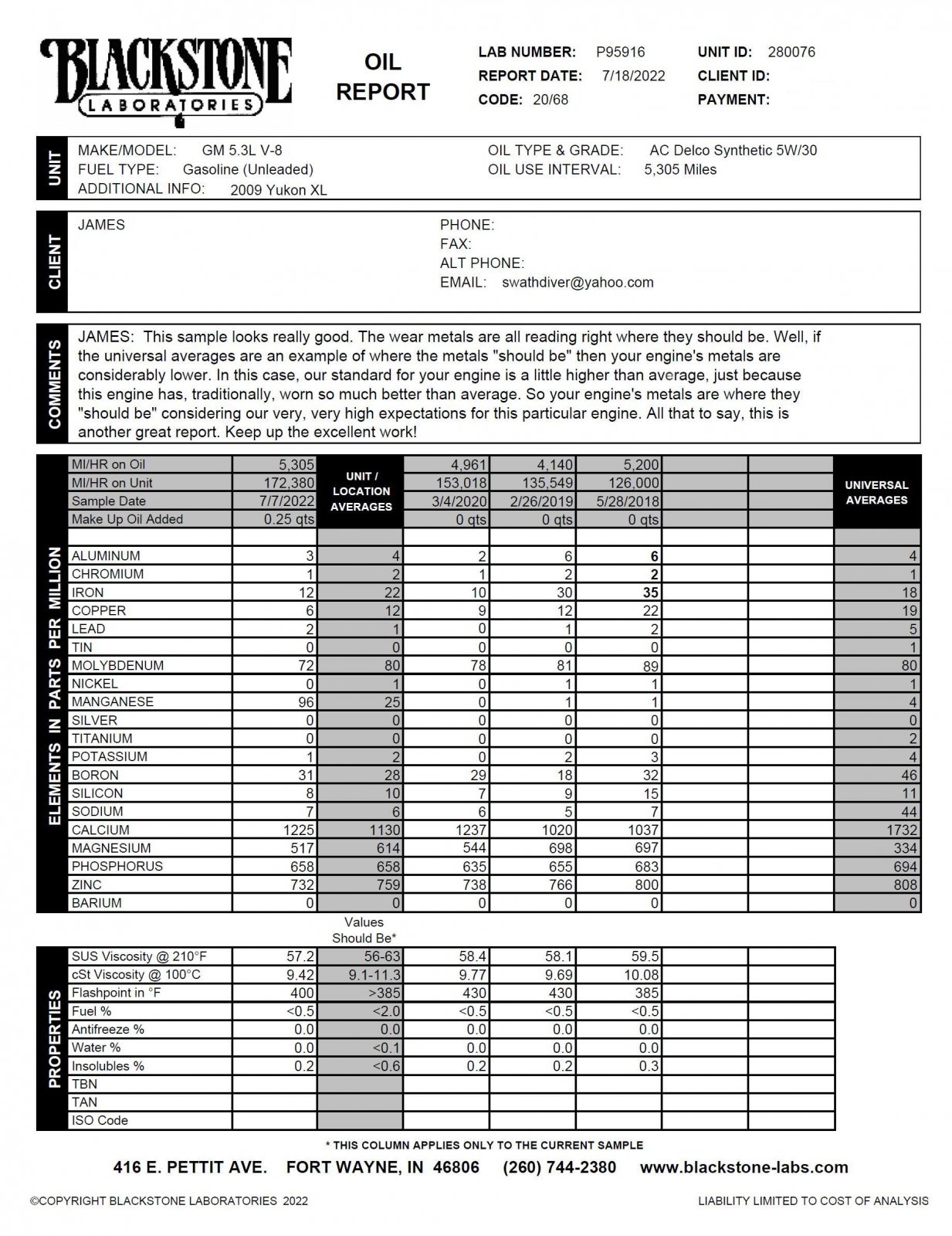

The whole report is that and more.
Maybe someone needs to start a "used oil FEEL analysis" business?
The measure viscosity but do they measure film strength? Not on my Blackstone reports.

My suggestion is to spend time learning at BITOG forum.
A UOA report shows the results of film strength, or the lack thereof, and many other properties.

If there was a lack of film strength the wear metals would reflect such.
Ok, I get what you are saying now. Would you agree that there is a significant difference in lubricity between new oil and oil that has 5K miles on it? Maybe not enough for my assertion that it is dead, but noticeable enough to feel the difference between ones fingers?
