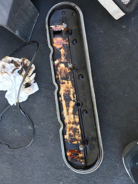

How many miles you got on this 2008? (average is 15k per year so I would guess 165,000?) Obviously this is a year model that had the bad design drivers side valve covers so it was probably changed out years ago? Now here is what I found with my 2009. The updated drivers side valve cover was on mine but it was covered with sludge and not functioning. For 60 bucks I bought a new one and put it on in less than an hour. Oil consumption is much better now. 3000 miles per quart used versus 1000 miles. It does make a difference. Plus if you do have a small rea seal leak if the PCV system is not functioning corectly it could make that problem much worse by pressurizing the crankcase forcing oil out anywhere it can squeeze out. Up through the piston rings etc you get the picture............
