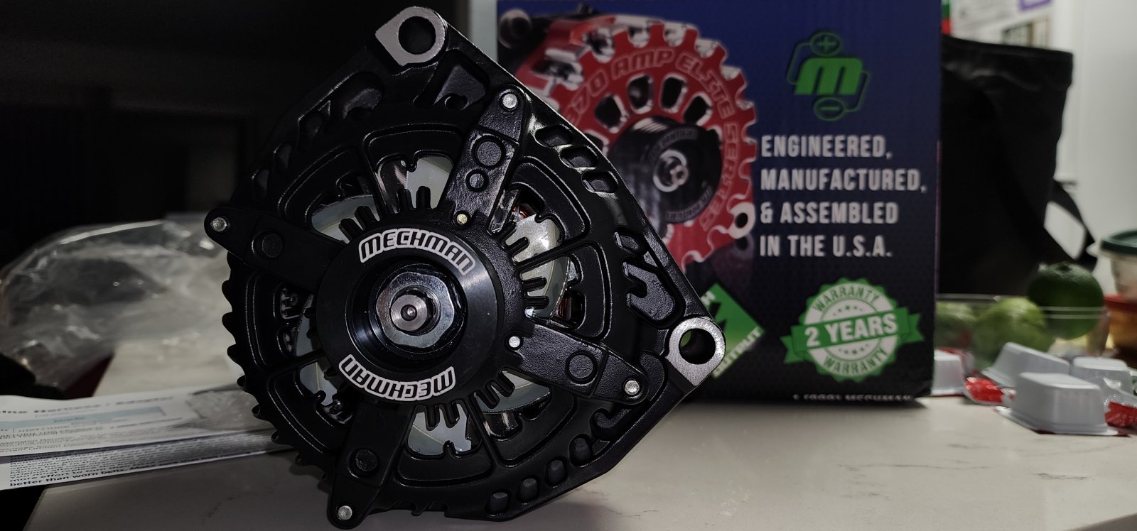

Part of the build... finally got my replacement Mechman Alternator!! Original one gave out a year ago. Upgraded to a better one and it's finally in! excited!20230322_202906.jpg
Black "320" amp. Previous was a 270amp RIP
Even though I got a 320amp, the bench test shows it puts out 400+ amps. What more can I ask for? oh yeah, and made in the USA
