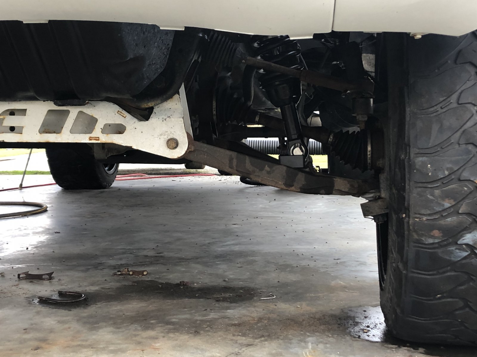

Shoot just found a pic I did have it raised up to 8.5” when I had the 37s on still no cv binding C5D3D368-AD1E-45F4-9585-1EAD774374A4.jpeg313FC45A-F88C-44A0-AAB3-7FE8FF0FC1E1.jpeg
Here’s how she sits now
BDB18B74-9A06-495A-8AAA-0DEA95F926B0.jpeg1F3FACC2-17B3-4E4E-8E61-6E5F49DDBB78.jpegit’s Squatting because I got the bed loaded down with mulch up to the rails

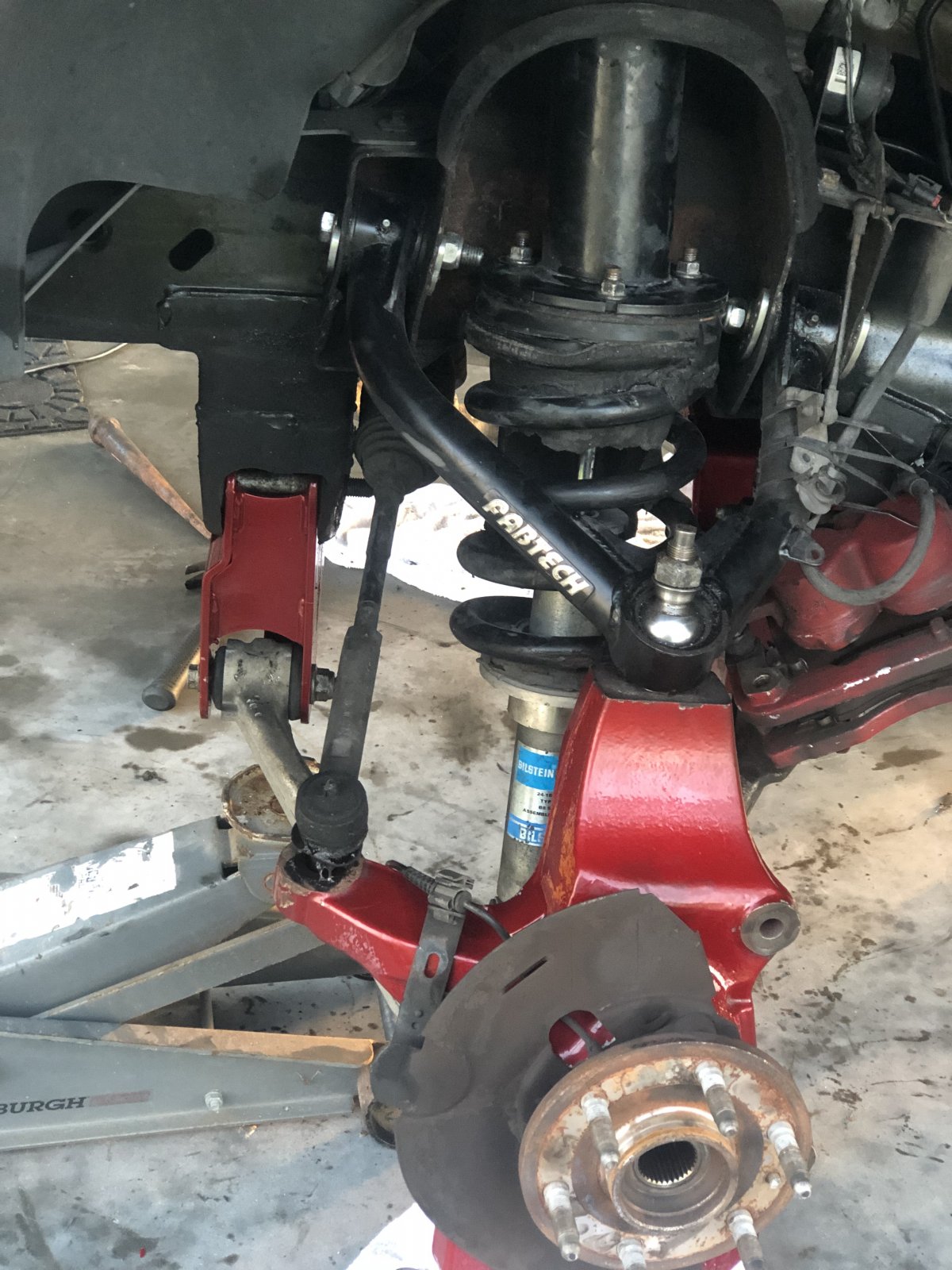

Ahhh I do remember that when I stretched out my lift with my old rc control arms they would hit the stock coil spring on the strut at full droop. More of a reason to justify to the wife of getting a set of fabtech arms!
?hash=74fa06adeda07a58551ba8c67cdd71ad.jpgYou can see how close they are to the coil over sadly I can’t find a pic of them with the stock struts installed 09F0E982-3E93-4B2D-8546-CC70EE2259A6.jpeghere’s the fabtech arms with the stock struts installed though and they cleared just fine!
