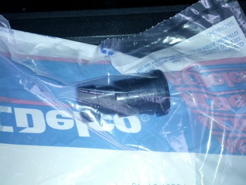

For reference, here is the part number and the part I'm replacing:

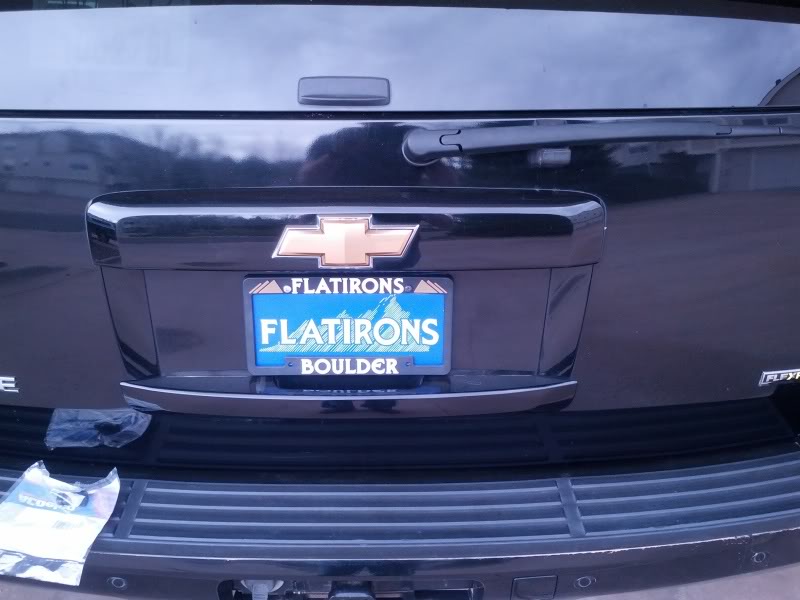

Here is the piece I'm trying to remove - it's the small trim piece that the bowtie and license plate lamps are mounted to:

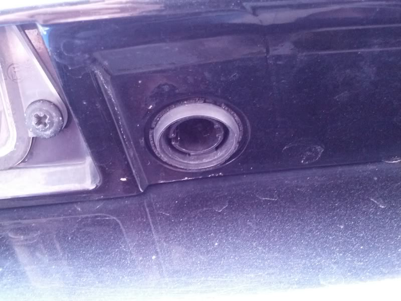

And why I'm replacing it..the old button is gone:
