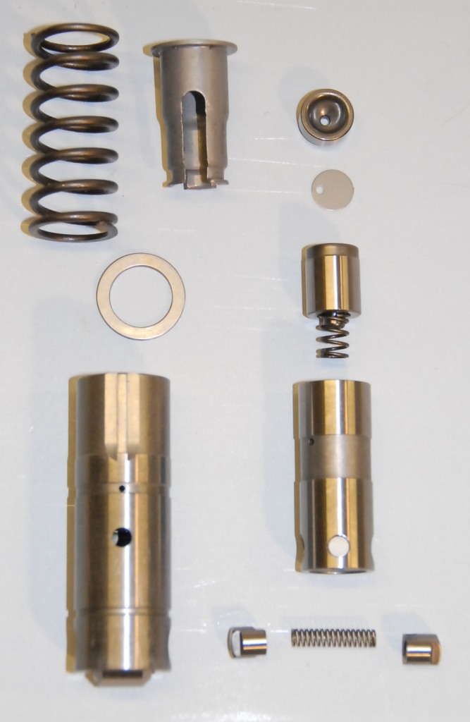

So this thing gets bounced up and down 1000 times a minute against a 300 lb spring and it's expected to last how many miles? afm lifter gm.jpg

Well, I left the Ford camp and purchased a new 22 burb last July, love the truck. This forum is great for all info related to our vehicles. Is there a mileage range when this lifter failure occurs? Reading the lifter related threads is seems mileage is all over the board. I only have 3600 miles As the owner of a new Tahoe, I appreciate your anxiety. If you want a trouble-free engine, my best advice to you is to go out and buy a 2022 Toyota Sequoia. Those engines will give you 300,000 miles RELIABLY. Unfortunately, the new EPA doesn't like them.
Well, I left the Ford camp and purchased a new 22 burb last July, love the truck. This forum is great for all info related to our vehicles. Is there a mileage range when this lifter failure occurs? Reading the lifter related threads is seems mileage is all over the board. I only have 3600 miles but every time drive mine I find myself waiting for the boom.

If I'm not mistaken, the really bad lifter issues were corrected for the '22 model year. I think the DFM system had issues from '19-'21, but they should have been fixed by '22.
My part time jobs have (2) 2021 Suburban LTs and (2) 2021 Yukon XL AT4s, and two had to have engines replaced somewhere between 10k and 15k. I haven't heard any issues with the '22 models yet.

The bad run of lifters were Sept.2019 thru March 2020 of Engine build date not vehicle build date. My 2019 Silverado was built in Dec. of 2018 and engine was built Nov. of 2018 I bought it in March of 2019. Our 2022 Tahoe was built in July of 2022 with an engine build date of June 2022 and bought 1-2-23. This range effects the 6.2 motor also.
The company that built these lifters and components were out of spec of what GM wanted is what they found.
