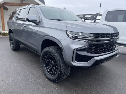

Going to switch things up for the wife soon. She wants smaller wheels with bigger tires. If anyone wants these wheels let me know! 20x9 295/60/20 less than 2k on them!
Z71 standard suspension, removed all red and silver.

Sure that’s stock suspension? Looks like at least a 2” lift.
Either way, looks sweet!!

We are in Montana. 3" for us too. They fit great. I did some trimming on the "cab" side to the brackets and drilled a hole to pull the fender lining back. Used stock hardware so it made it look OEM+.
