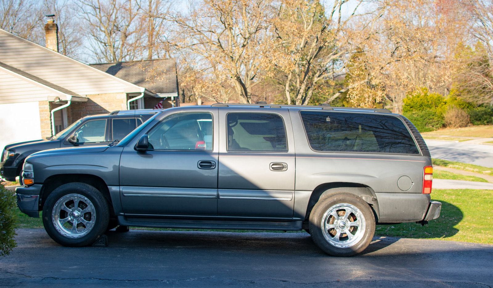

    Bought a set of 20x10 (-25mm offset) Weld Dunes a few months ago. Going to do a 2-2.5" level in the front with z71 springs and 1" or 1.5" coil spring spacers. I can't decide on tires to save my life. The tires in the pic are 305/50's and they came with the wheels. They are long gone now. I do not want to trim much if at all so I've been looking at 275/55, 285/50, and 285/55's. Any suggestions?

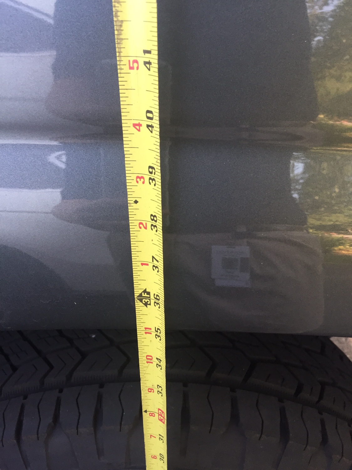

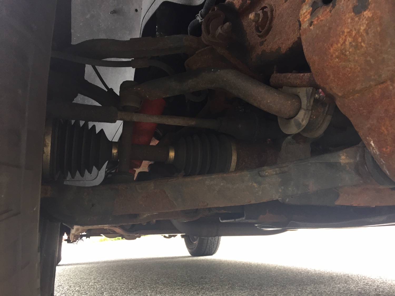

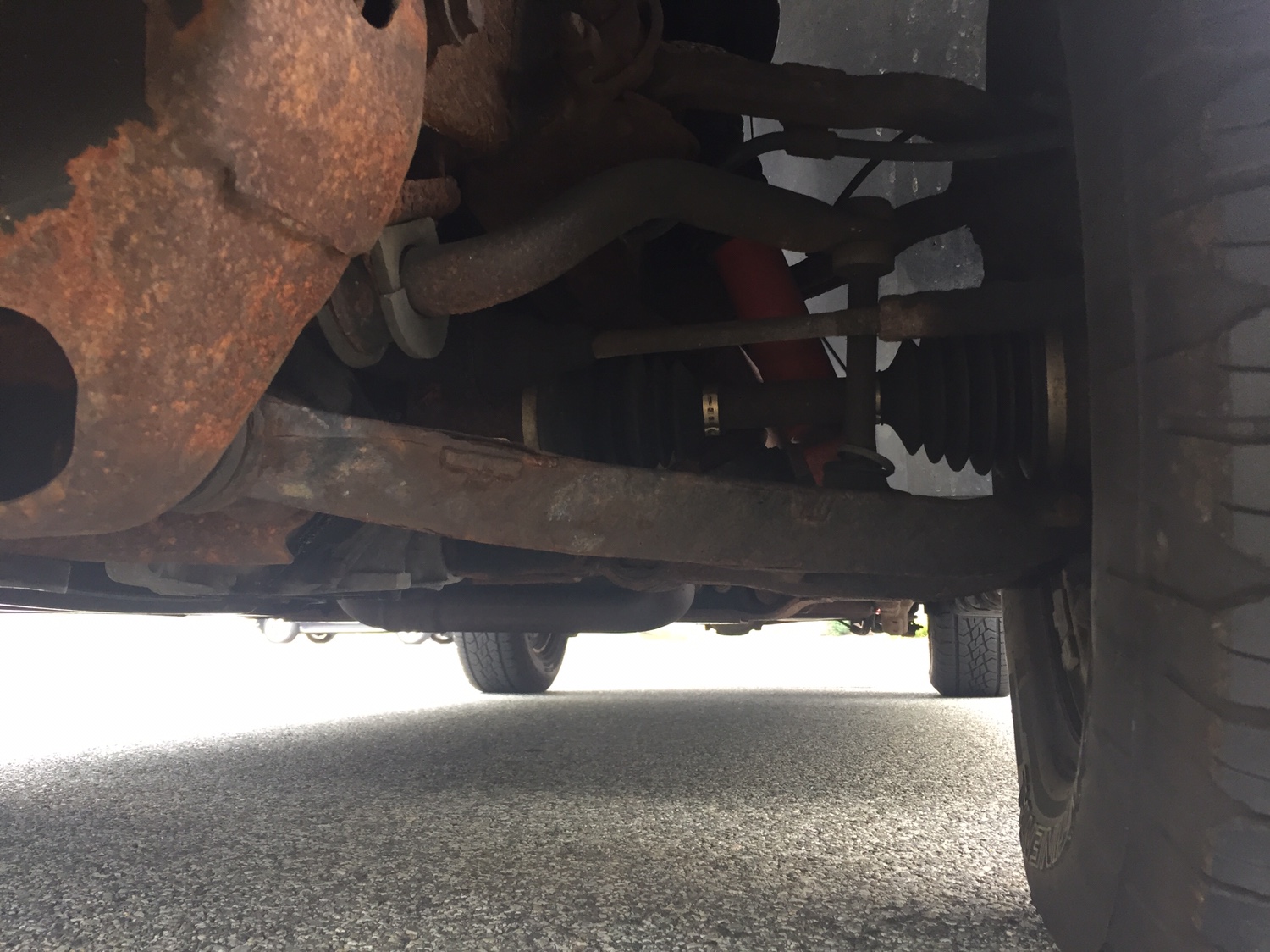

    I just noticed that your truck sits very level as it is. Are the OEM tb keys turned all the way up? Any higher in the front and its SoCal. Will you post pics of the tie rods and upper control arms in front? Would be good to know what you have going on under there.

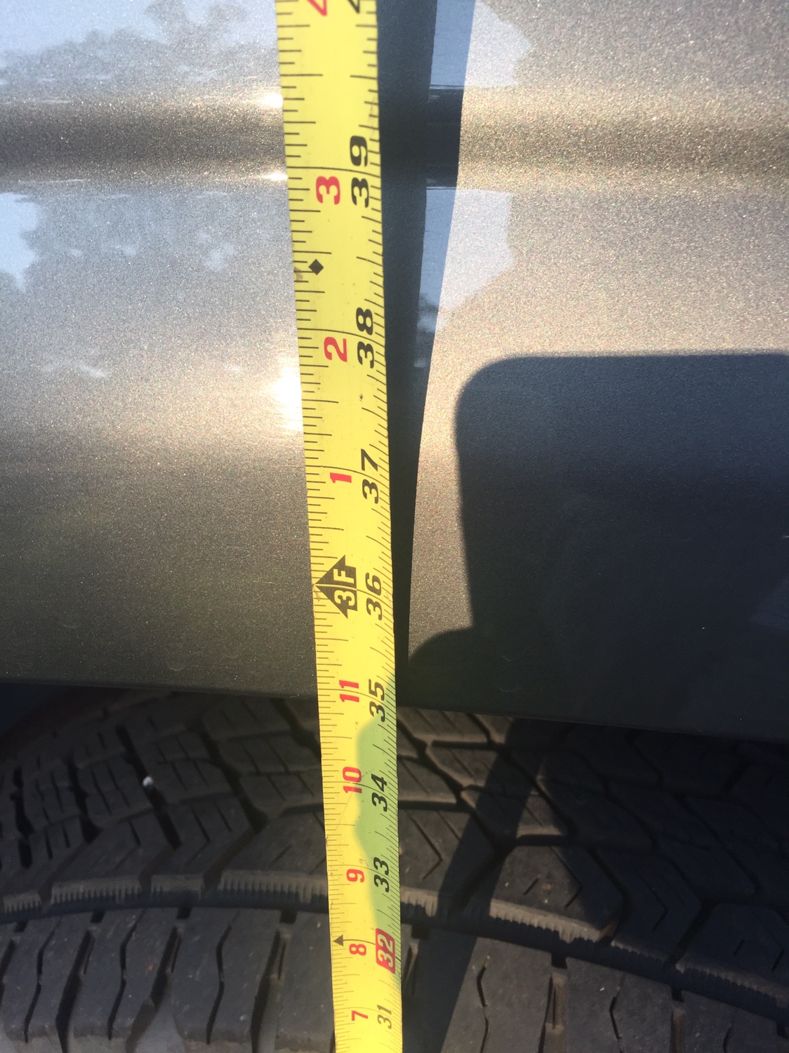

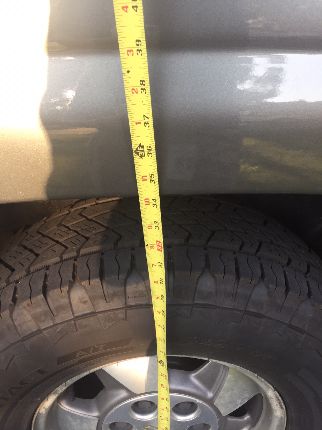

    Got some fender measurements this morning. First two are driver and passenger front and the bottom two are passenger rear and driver rear. My driveway is on an angle and it slopes off to the grass so that's why the one side is lower

    I have noticed it sits lower than most nbs tahoes and burbs so idk what the po did

    Here's the suspension pics. Don't mind the rusty frame. Haven't had time to sand and coat it
