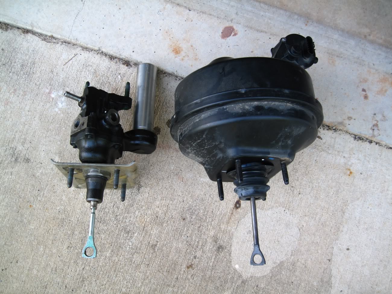

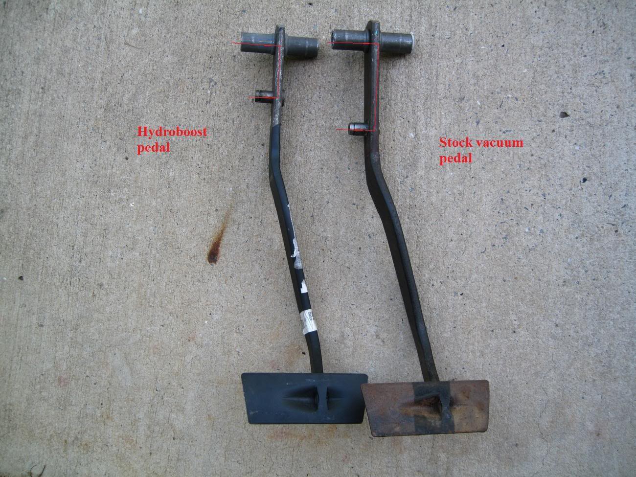

2000-2006 seem to come with Vacuum Buster, 12" inch Front Brake Rotors, Single Piston Calipers, and Rubber Hoses.
We can do better than this, at a price. What are better brakes worth to you???
Hydro Busters seem to be much better than Vacuum Busters.

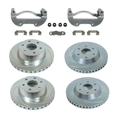

The 2007 + Front Brake Rotors are 13" 1" bigger than 2006 and older. And that the 2007 + Front Brake Calipers come with 2 pistons. Direct Bolt-On make this modification very tempting.

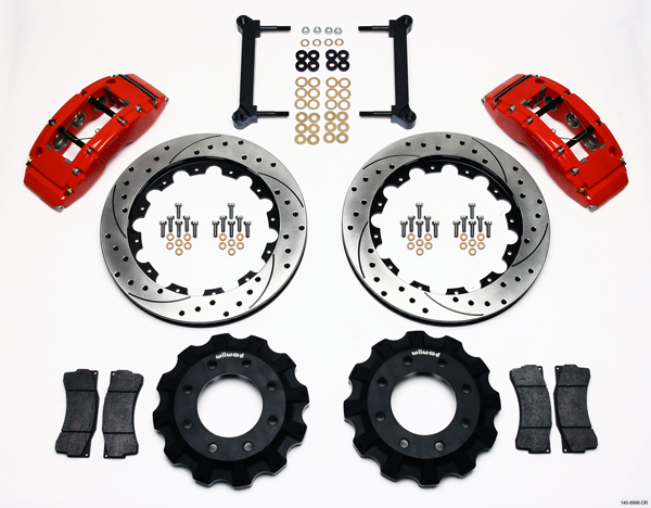

There is the Summit Racing 14" Front Brake Rotor and 2 Piston Caliper adapters. Meant to be used with 18" wheels or bigger.
And of course the Wilwood 16" Big Brake Kit. Meant for 20" wheels or bigger.
