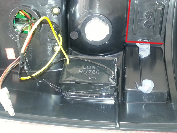

So first off you have to remove the black box with wires in it and relocate it.
It was originally where the blue square is. you have to move it where the picture shows in the red circle.

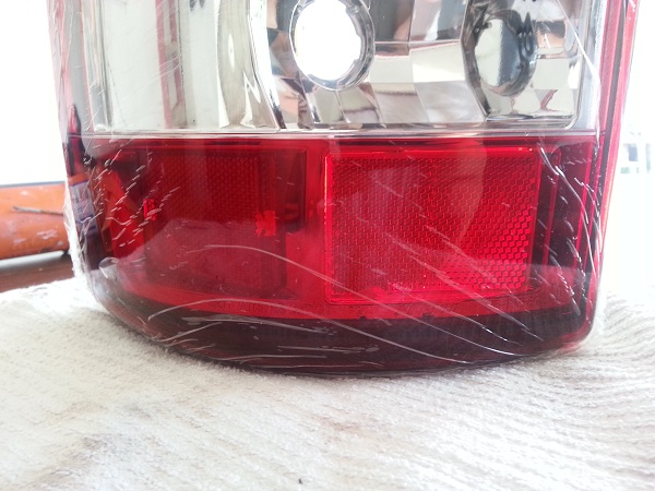

These next 2 pictures show where you need to cut.
Here is what it looks like after you cut it.
Here is the piece you cut out. The reflector used to sit on the large flat piece. Clipped into the hole on each side.
Here is what it looks like before you set the reflector into the new hole.

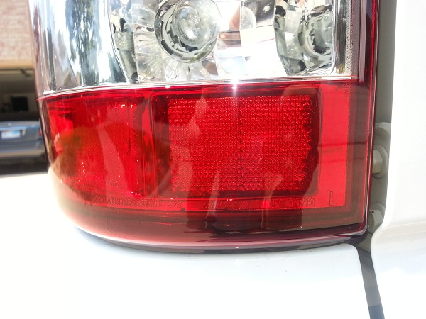

Here is with the reflector set into the hole against the outside lens.
This is the outside view with the reflector in place.
Here is it all glued in and ready to install.

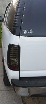

they make these that have a smoked reverse section so it isnt as bright
http://www.ebay.com/itm/00-06-Subur...oe&hash=item1c3896c7c1&vxp=mtr#ht_3600wt_1166
These are a different light, and definitely won't fit a barn door model

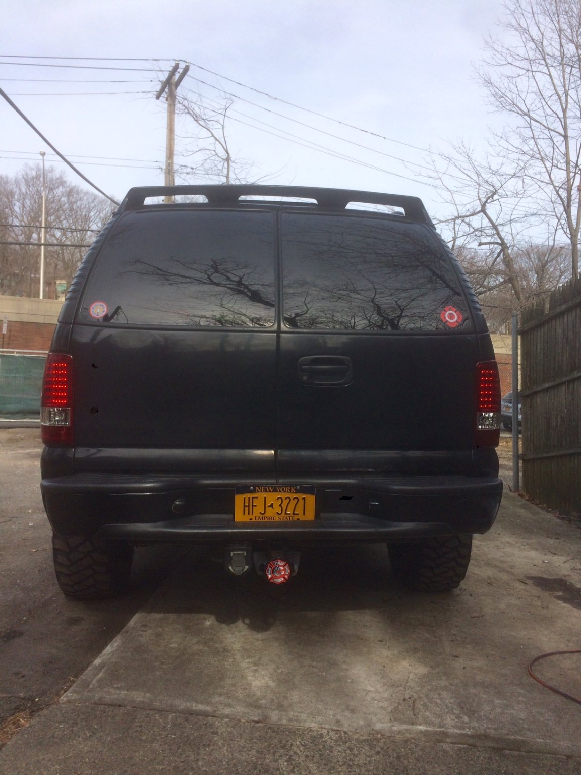

Thanks to YukonXL04 I used the same lights except the smoked version. They worked out nicely and was not a hard mod at all thanks to this thread. You will have to install load resistors due to losing cruise control, but definitely a great upgrade not many barn door tahoes out there with LED tails.

May be hard to see I have some more pics in my albums, I have pictures of them lit up too.
