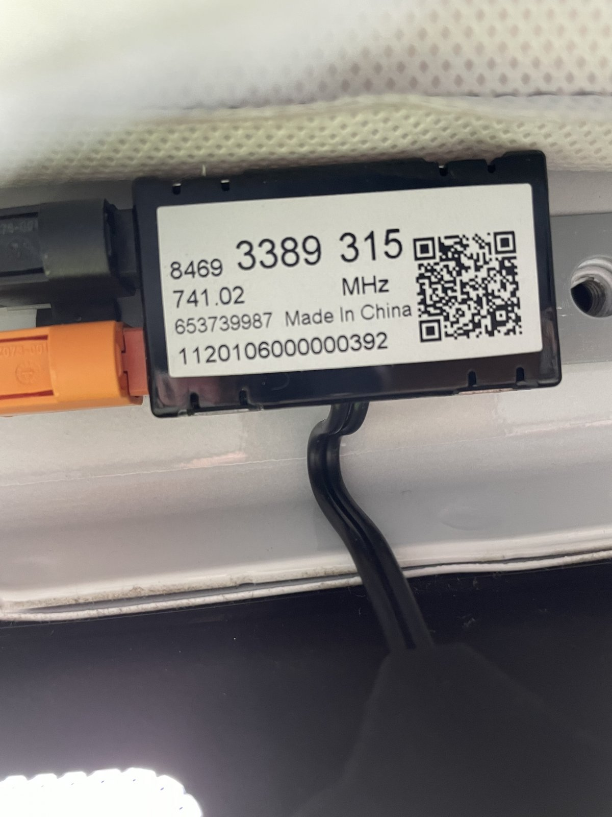

Same thing happened to my 19 Denali. I could be standing next to it and fob wasn't recognizes-other times if I turned sideways it would work. Dealer finally replaced antenna amplifier and problem solved.
