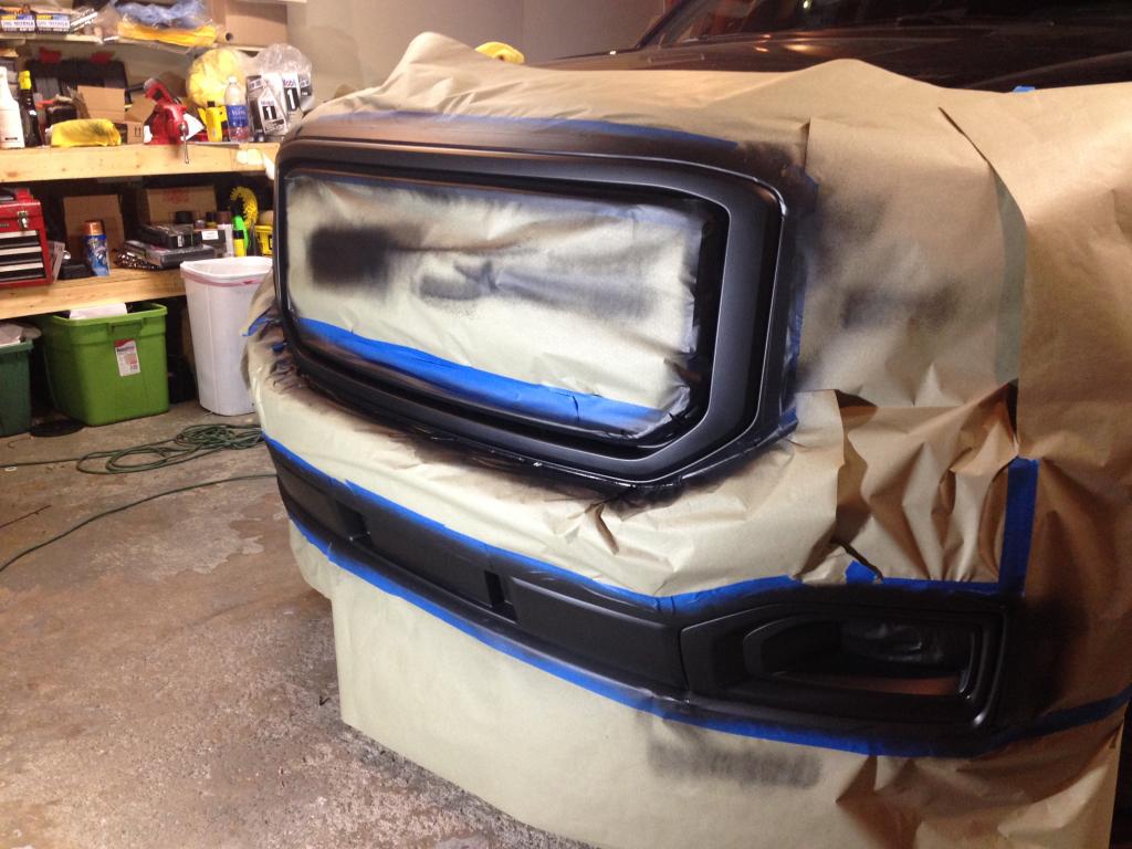

Alright First Post ... I bought this truck about a month ago...Hated the blinged out front end...
I always liked that All Terrian Package on the Sierra. So Thats the idea I had in mind starting this project. Let me know What u think.
Also I had to some Bondo work on the plastic from the stupid license plate bracket..
For the dippers out there it was about 7-8 coats of black and 2 coats of glossifier.

Looks awesome! Did you scuff it up before hand or just tape and spray?

Just clean really good and spray. no scuffing.
I can peel it off if i want.... and the chrome will look perfect.
Now i will try and get a pic of the difference between the grill and the paint but its not an exact match.
But hey its only a plasti dip job not a real paint job. But its completely reversible.
Thats the beauty of dip.
I only did the glossifer so it was a little easier to clean.. Straight dip is a bit harder to clean .
