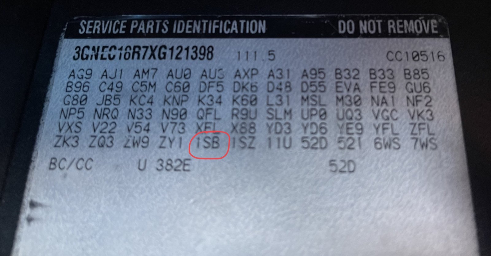

RPO sheet in your glove box door.I have a 1999 Tahoe 2 Door with the 5.7 Engine. Is there anyway that I can tell what trim I have? Base, LS or LT? Thanks!
Awesome. I will check tomorrow. Thank you very much!RPO sheet in your glove box door.

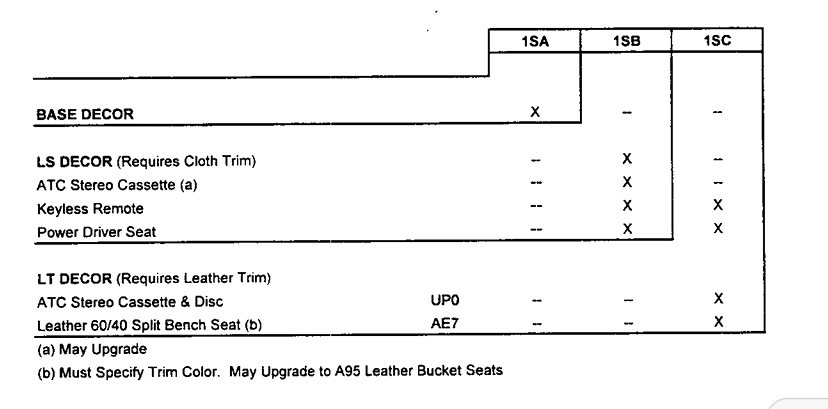

Thank you, sir.It’ll be one of three codes, 1SA, etc.
Vinyl seating is base trim, cloth LS and leather LT. Sport trim is code BYP.

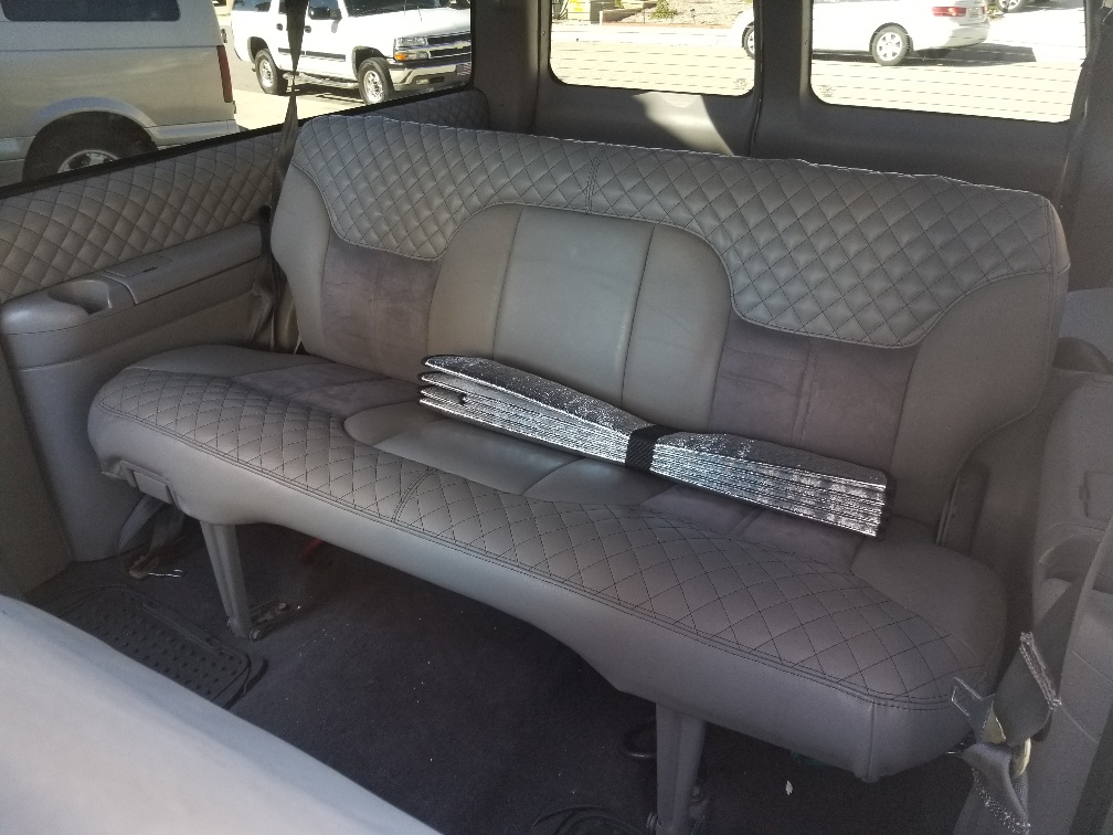

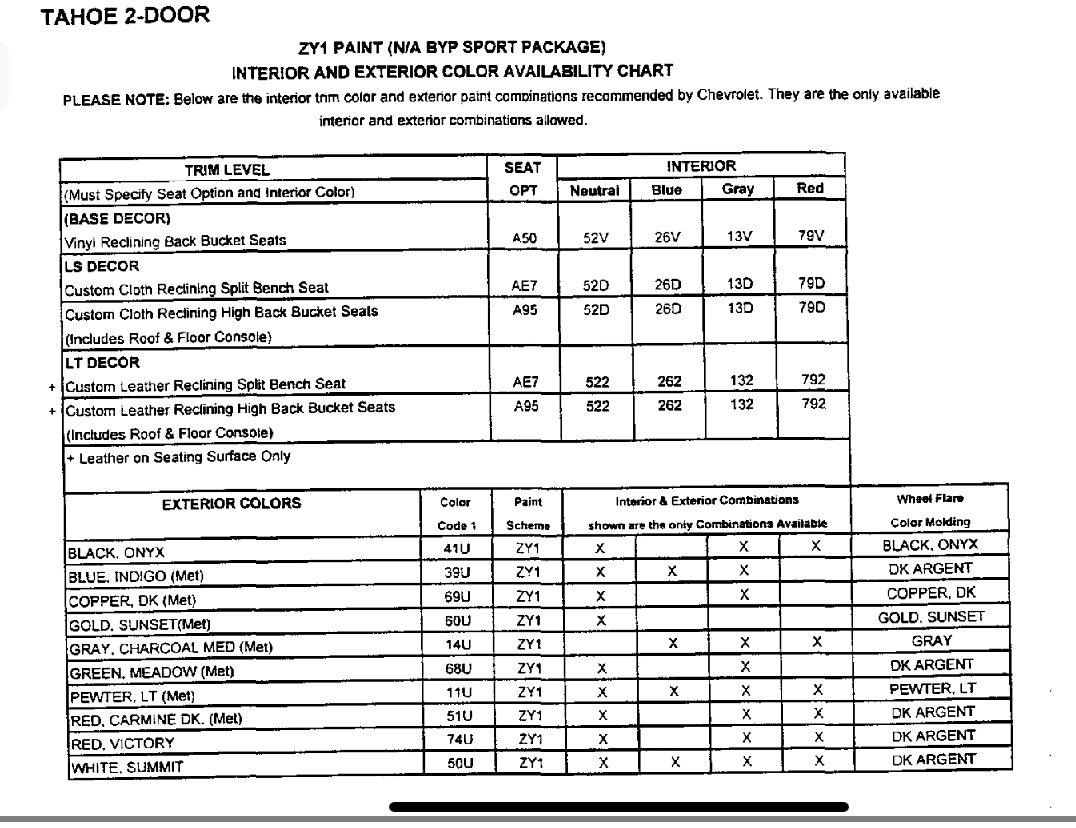

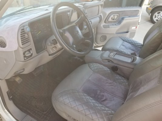

Any idea which code goes with the seat and seat belt color? I looked up 52D, but it shows it as a light neutral and looks like a tan. However, my interior is gray. Thanks.Yep, that’s the trim package.
