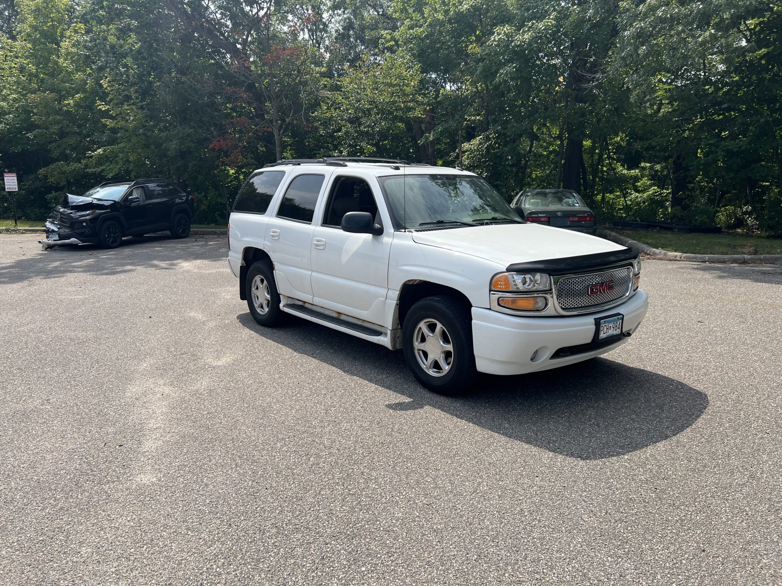

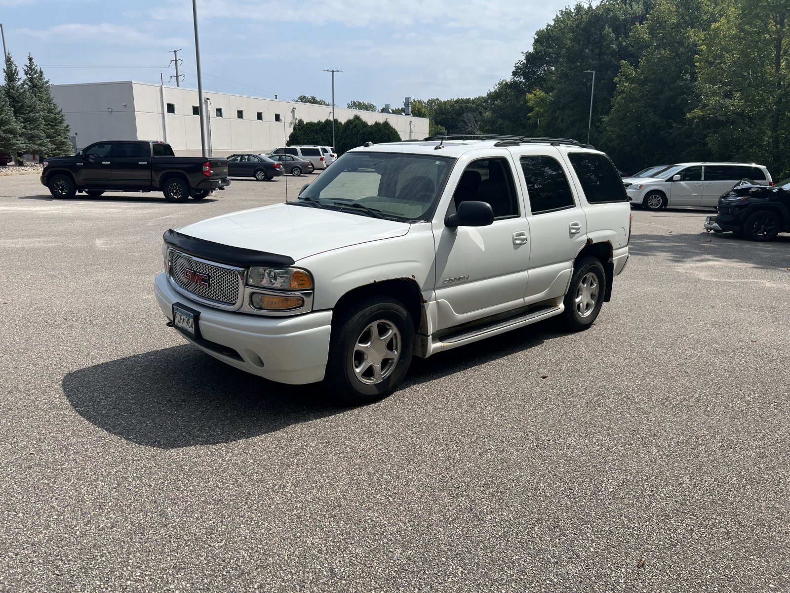

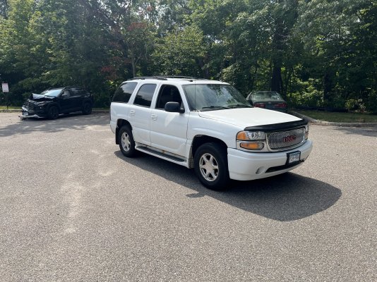

Pics of the truck, please.

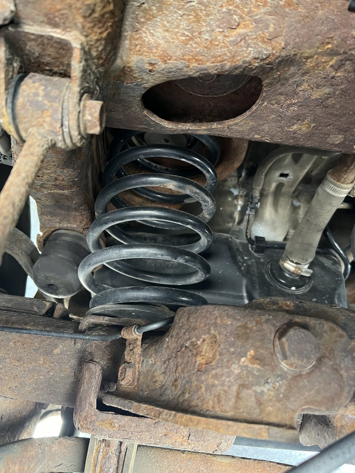

Added a few photos, little rusty but have plans to fix that or atleast stop it the best I can! I also included the RPO codes and a picture of the spring, I couldn’t see any part number stickers on it what so ever.

Looking at the springs, I'd say that they are not original springs, and there is no corrosion and/or accumulated road dust on them, and for a GMT800 truck and its age, there should be. As such, I don't know of any way to determine their specs.

BTW...... Your springs "look" pretty much newer than an original spring would look like by now??
Original factory springs usually have a sticker wrapped on the lower spring, and usually survives the age, to still be readable.
