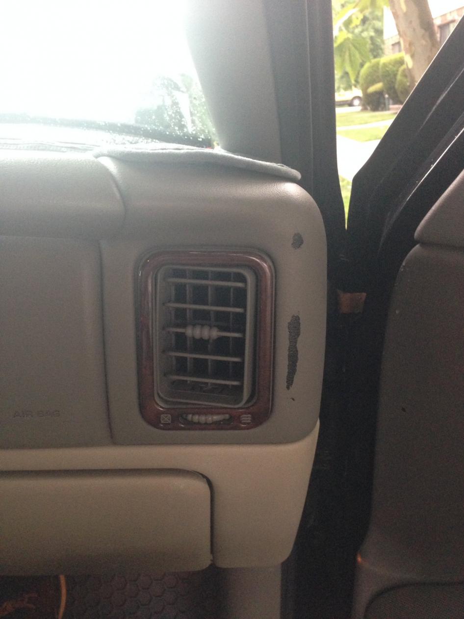

I will use this thread to post my progress and will upload pics. I'm happy to answer questions.

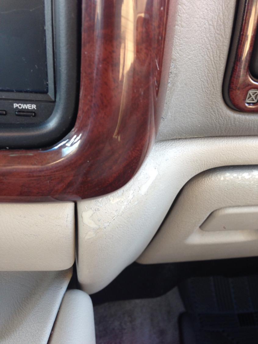

Attached is a pic of the first part that needed to be restored.

So I sprayed a "Prep cleaner" onto the surface and wiped it with a lint free paper towel. I then took a green scuff pad and CAREFULLY scuffed the area to be painted. You need to take caution with this step so you don't end up peeling up more of the factory paint. Once dry, I applied "Plastic Primer" with a foam brush. Make sure you apply it evenly without drips. I let it dry 8 hours and then applied a second coat of primer (company says you can use a hair dryer to speed up drying times). Once dry, I applied a light coat of Shale "Dye Colorant." The idea is to BUILD the color with 3-4 coats of dye. If you apply too much dye on any coat, you will be able to tell it was painted and you might cover the grain of the plastic. Do not try to completely cover on the first coat. Here is what it looked like after 2 coats. I ordered "low gloss" dye which is a little too dull for my dash, but once it is fully cured, I will use an interior cleaner to shine it up slightly. I also purchased a top coat in semi gloss that I will experiment with.
Edit: uploaded a clearer pic.

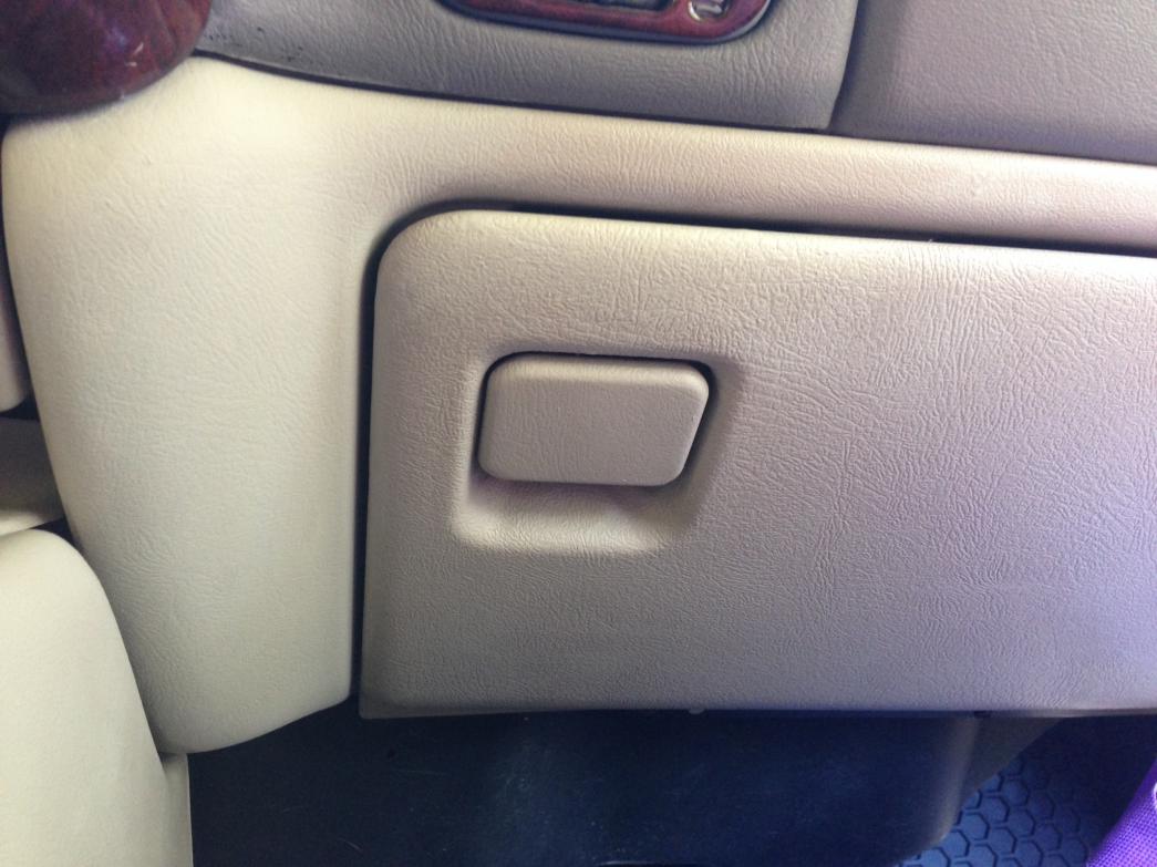

Well, here it is. Looks pretty good. I could have peeled a larger area of the existing paint and made a "seam" in an inconspicuous area, but I'm happy with how it looks now, so I'll stop here.

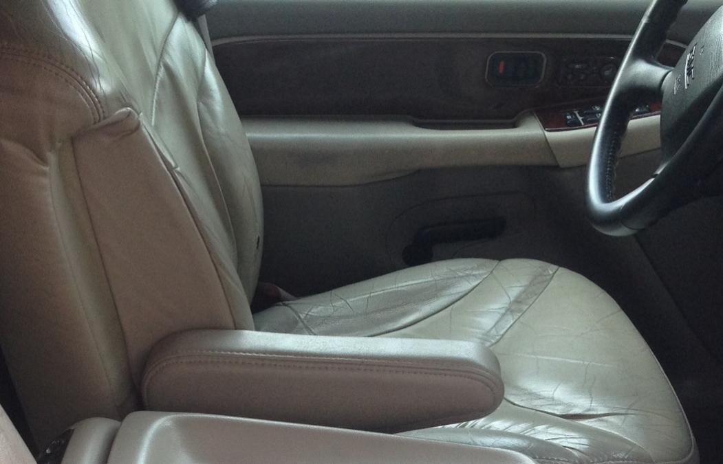

Drivers Seat Cover Before.......
(Note the creases and cracks and the hole in the seat. One panel was dry and rough like sandpaper. This seat cover was really ready for the trash. My restoration came out great considering how bad the condition of the seat cover was)

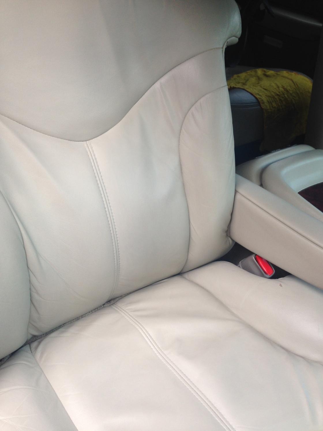

After......
DISREGARD THE "dot" YOU WILL SEE IN ALL MY PICS. My iphone 5 has a piece of dust in the lens.
Yukongk
Yukongk
Apr 14, 2013
776
12
NY
Passenger seat after......
(Don't have a before pic but it was the same color as the drivers side, but in slightly better condition with only a couple of scrapes and cracks that I used adhesive and filler to fix)

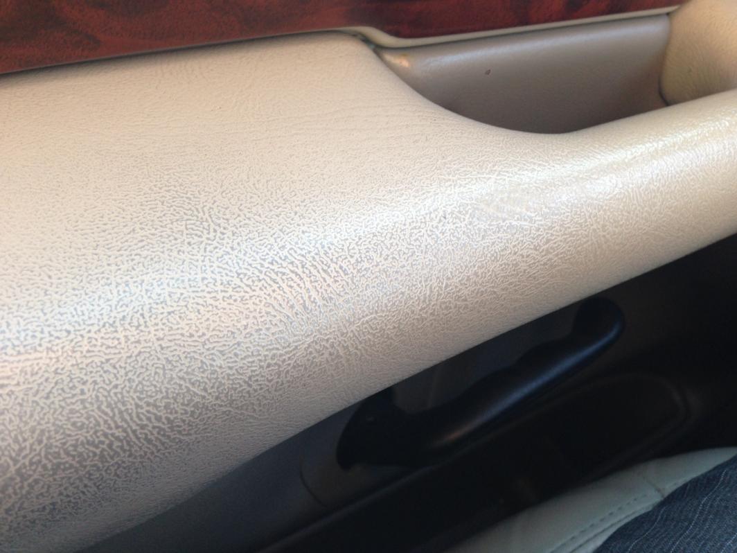

Driver side door handle before.......
(At first I thought it was just dirt in the cracks but upon cleaning and further inspection, I realized the paint was worn off)
Yukongk
Yukongk
Apr 14, 2013
776
12
NY

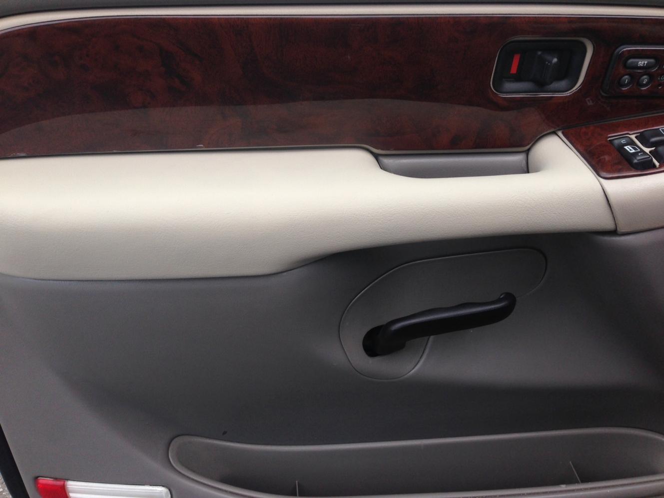

Driver side door handle after.....
(2 coats of plastic primer and 4 coats of dye colorant. I'm going to let it cure overnight and coat it with semi gloss clear topcoat)

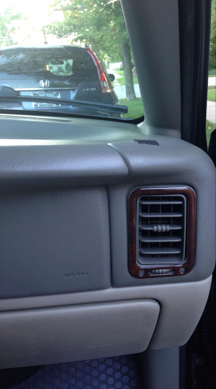

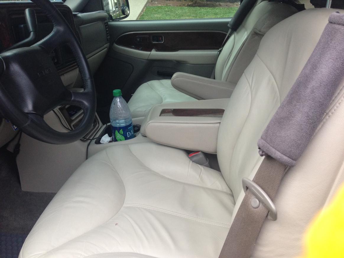

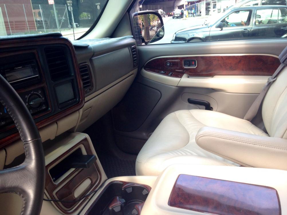

Thanks for the feedback guys. Here's a glimpse of my interior (I think I'm done ......for a little while anyway, until I work up the patience for the double din conversion) :
