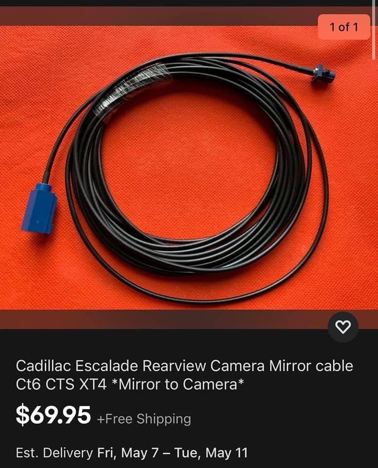

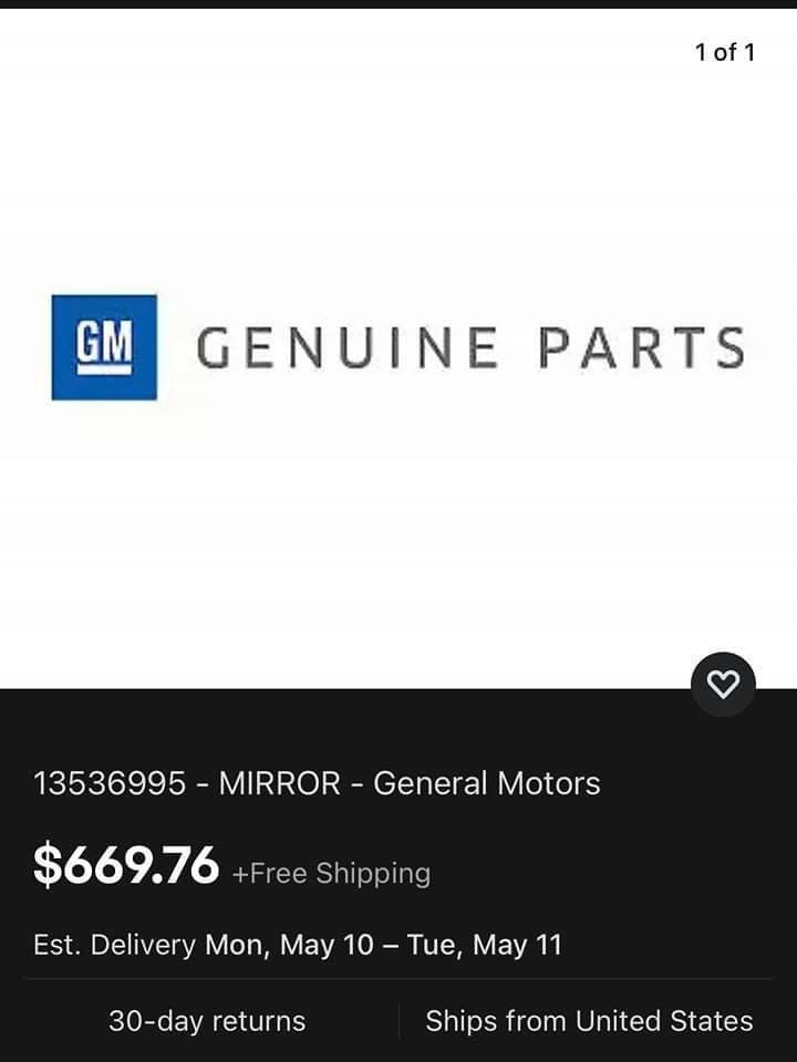

There’s a 5/3 post in the “GMC Yukon AT4 Owners” Facebook group where a guy bought all the Denali parts from eBay. 280567A7-B4B5-4CF7-86AF-7F02A86C1A89.jpegD518B230-810D-4978-8F8D-8454FEC89639.jpeg
note: this is from Facebook, I take no responsibility if you spend $900 and it doesn’t work.

Thanks a lot! This is VERY helpfull! I will try to find these pieces, and do more research. Hopefully, it will work.

No, the electronic mirror requires a secondary camera that is next to the backup camera in the Denali Trim.

Do you have a link to that post? I'm new to the forum and still figuring out how to navigate. Tia
Sorry, I don't. I remember the guy did not include a detailed write-up (or I would've copied/pasted). Just said he bought those three items, installed them... and it worked. Wish I could help!
