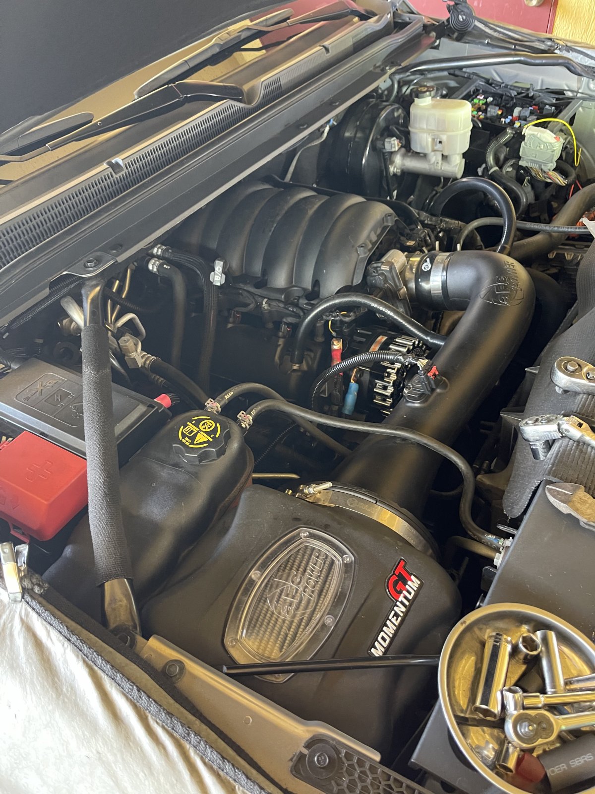

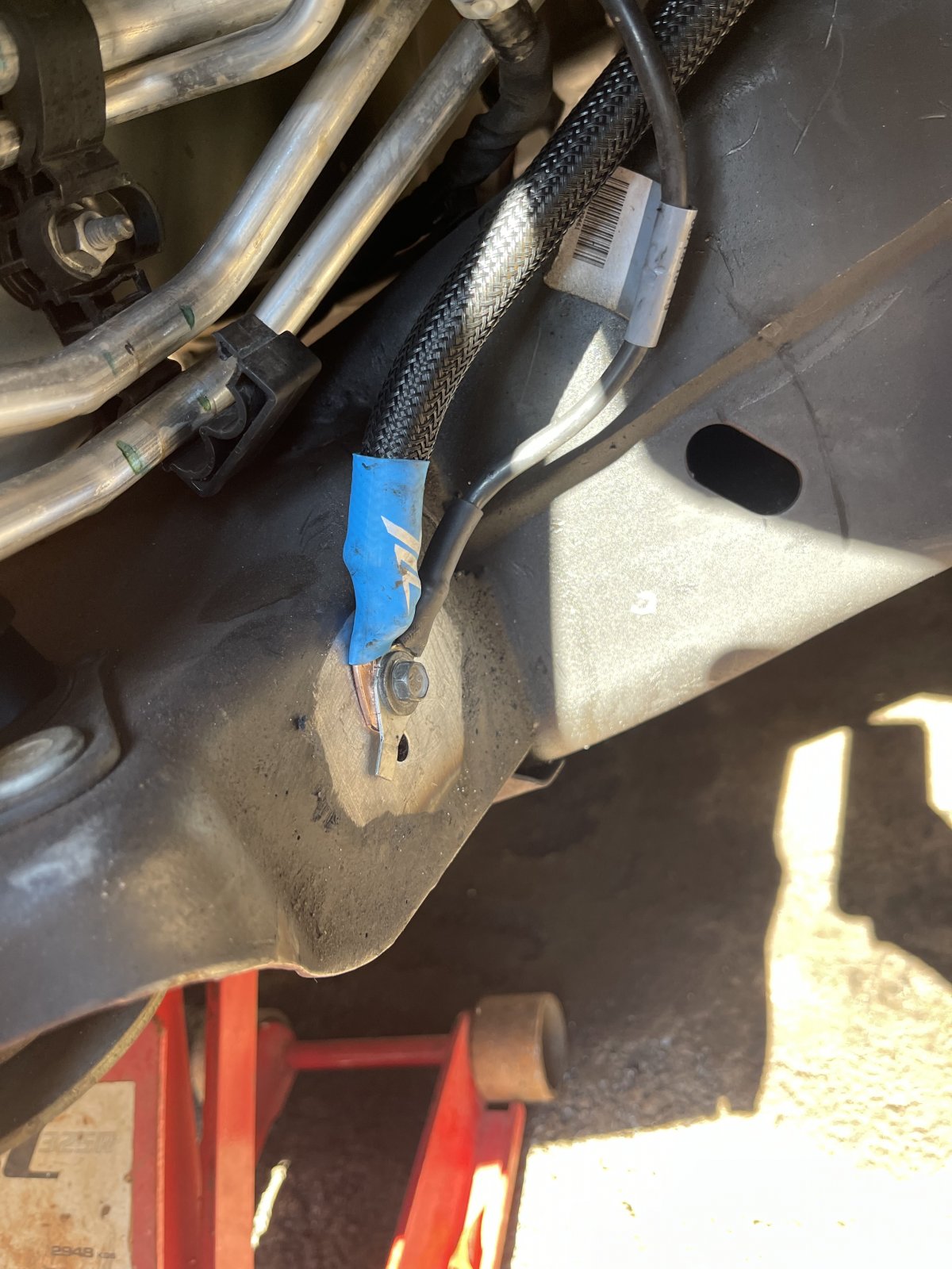

Got a chance to install the 370a mechman alt along with the XS 4800 and also did the big 3 on my 2018 Premier Tahoe . Installation was pertty simple thanks to Tony from mechman .

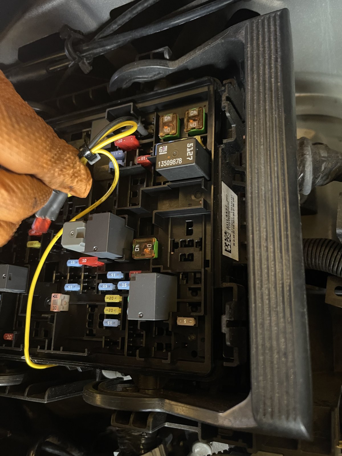

Alternator came with the 1 yellow wire harness & p103 module for the stock alt plug .tap in to the police accessories since for the yellow wire.

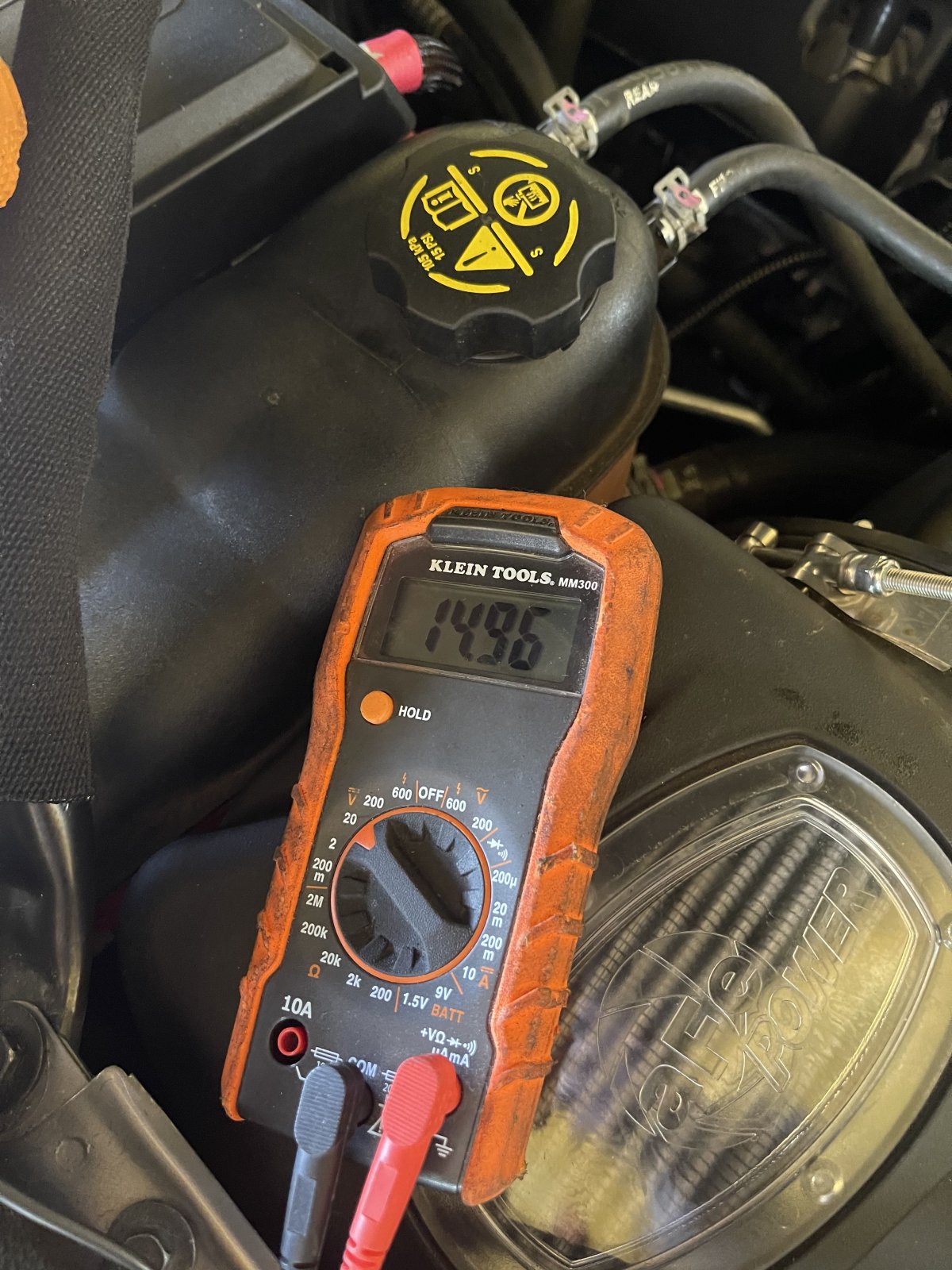

After all that what done voltage was at 14.9

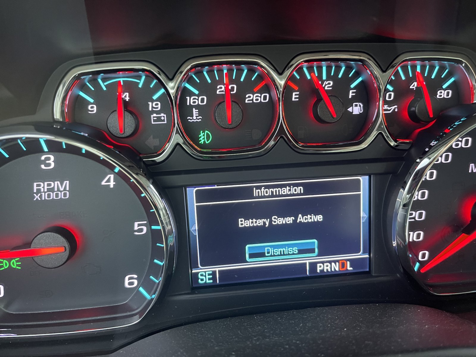

It was running fine couple days after installing the alt.wife drove it to work at the stoplight half way to work the battery saver showed on her dash . She said it was driving fine no problem ac cold / headlights & fogs / radio etc Was working fine but she notice the voltage on the dash was around under 14 give or so with with the battery saver mode display on the dash.

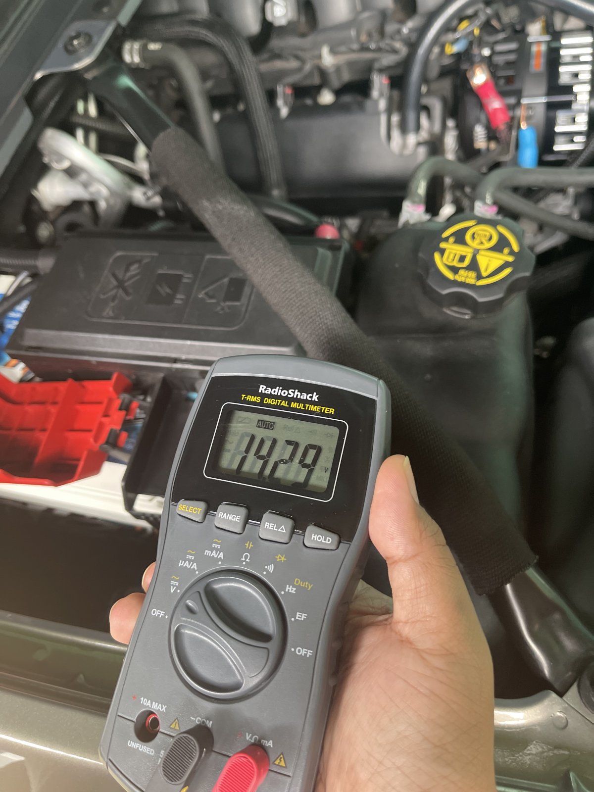

I check when she got home .Check all the connections .thinking something got lose .check the p103 module if it’s came out was fine .battery terminal was fine . Everything seem fine .turn it on there was no battery mode display .check the voltage it was around 14.3 it pertty low if you ask me .
Let it seat for couple day .cold start it was 14.3 disappointing.with ac on highest setting headlights & fog light one voltage reads about the same on ideal .Now sure what’s the problem.i message Tony Friday Jsut waiting for his reply on Monday . Did any of you guys installed a big alt on your 2015 & up Tahoe/Yukon ? Any problems Lmk guys what to fix this problem before I start ordering my sound system .
