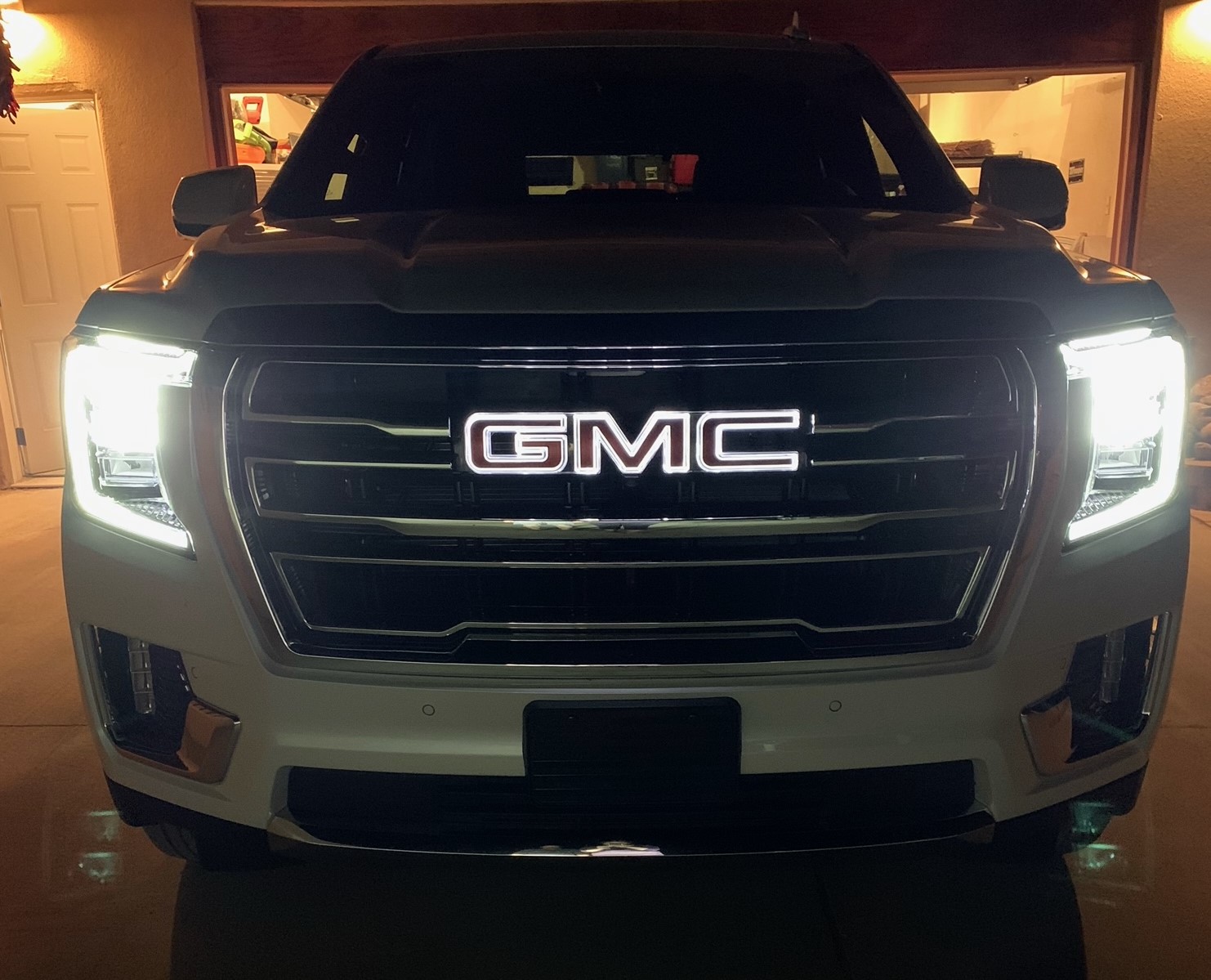

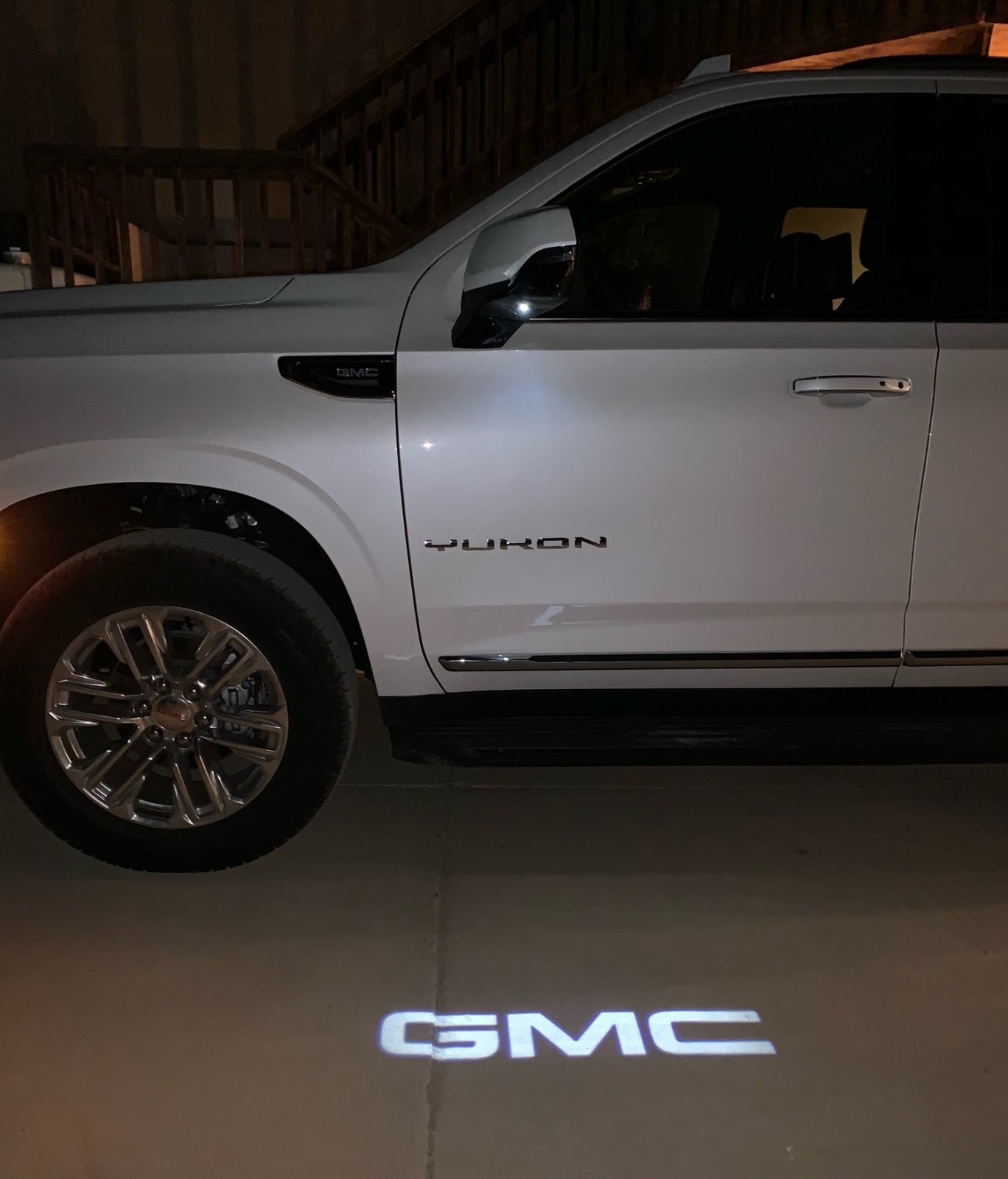

The GMC Illuminated Grille Emblem and mirror puddle lights come as plug and play accessories.

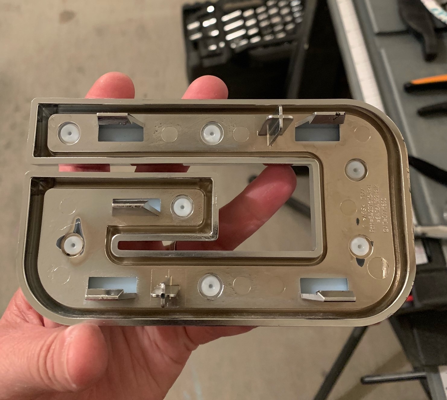

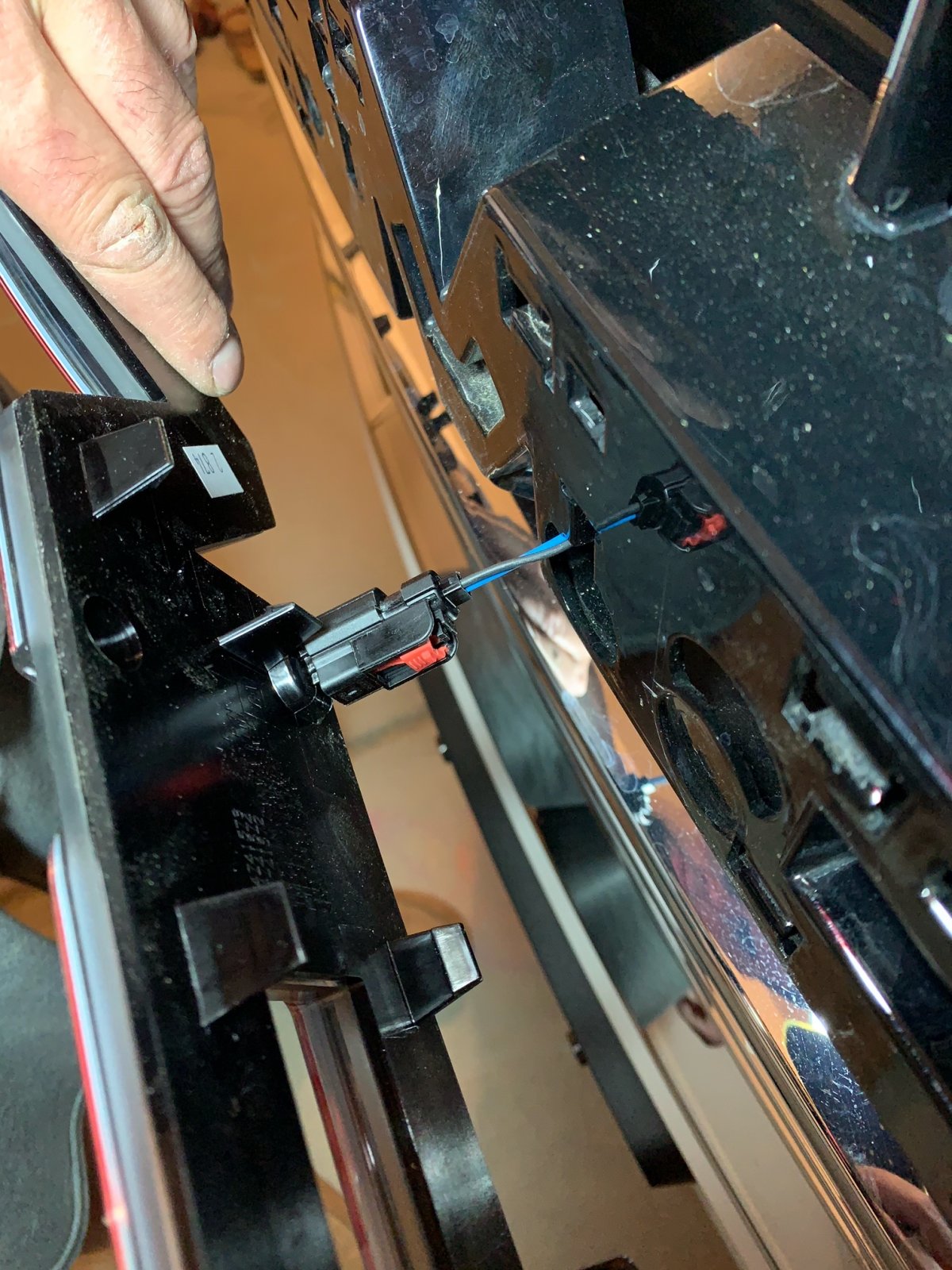

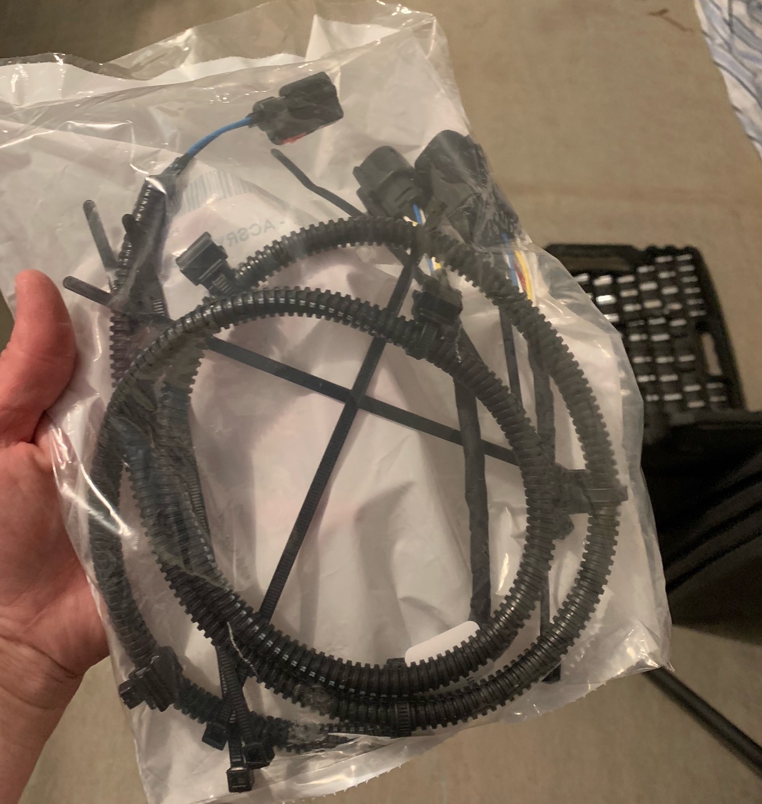

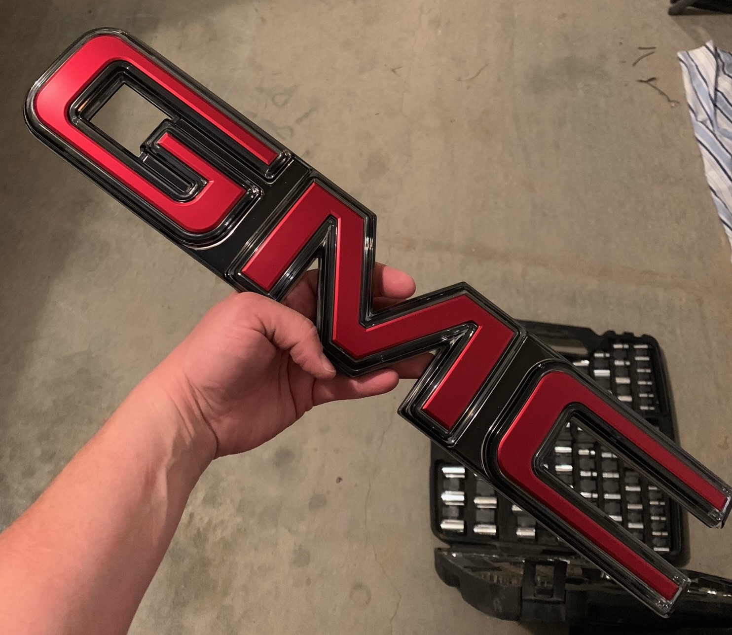

The Grille Emblem comes as one piece with a wiring harness. It does not come with instructions, but it is pretty self explanatory.

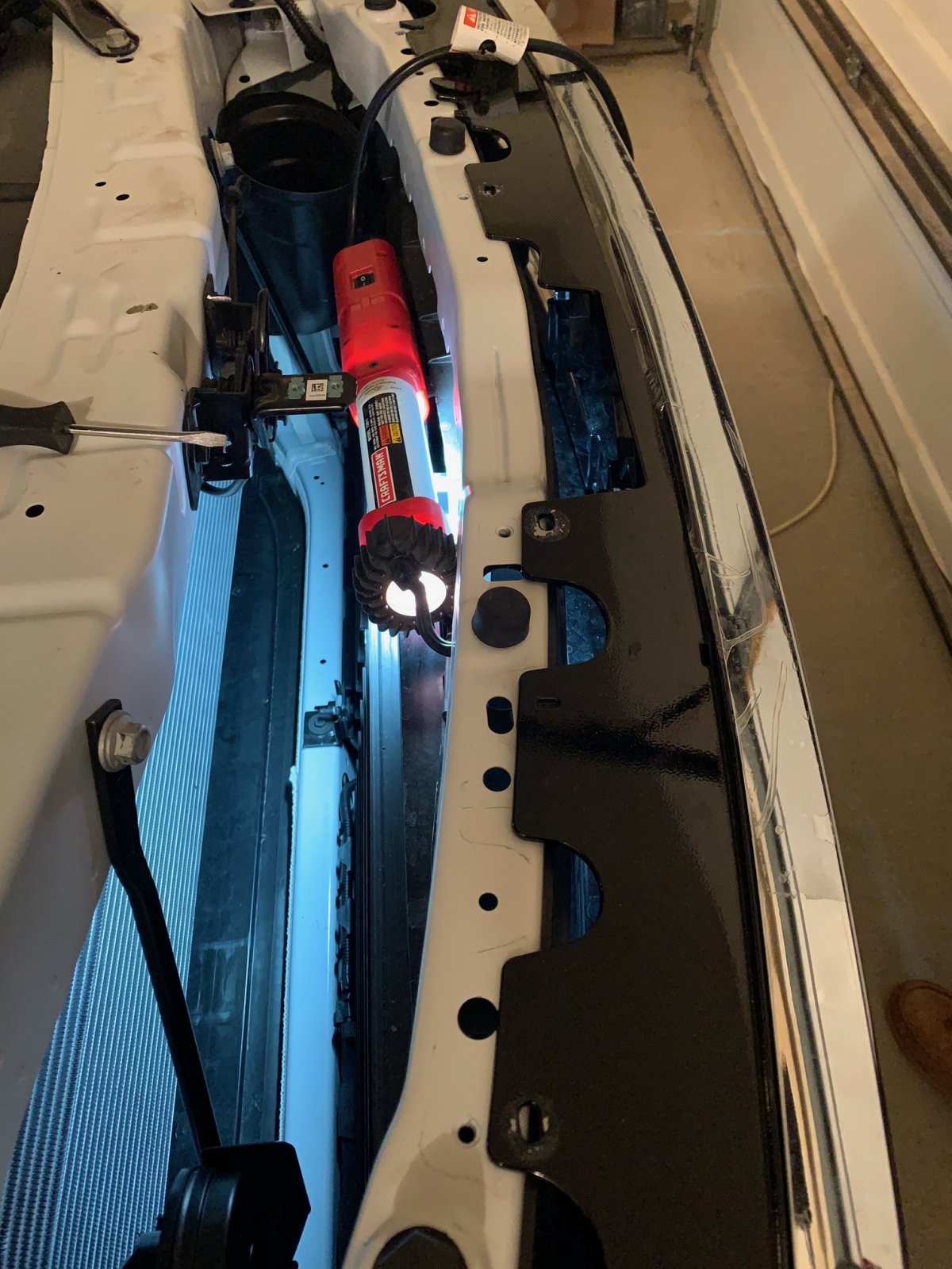

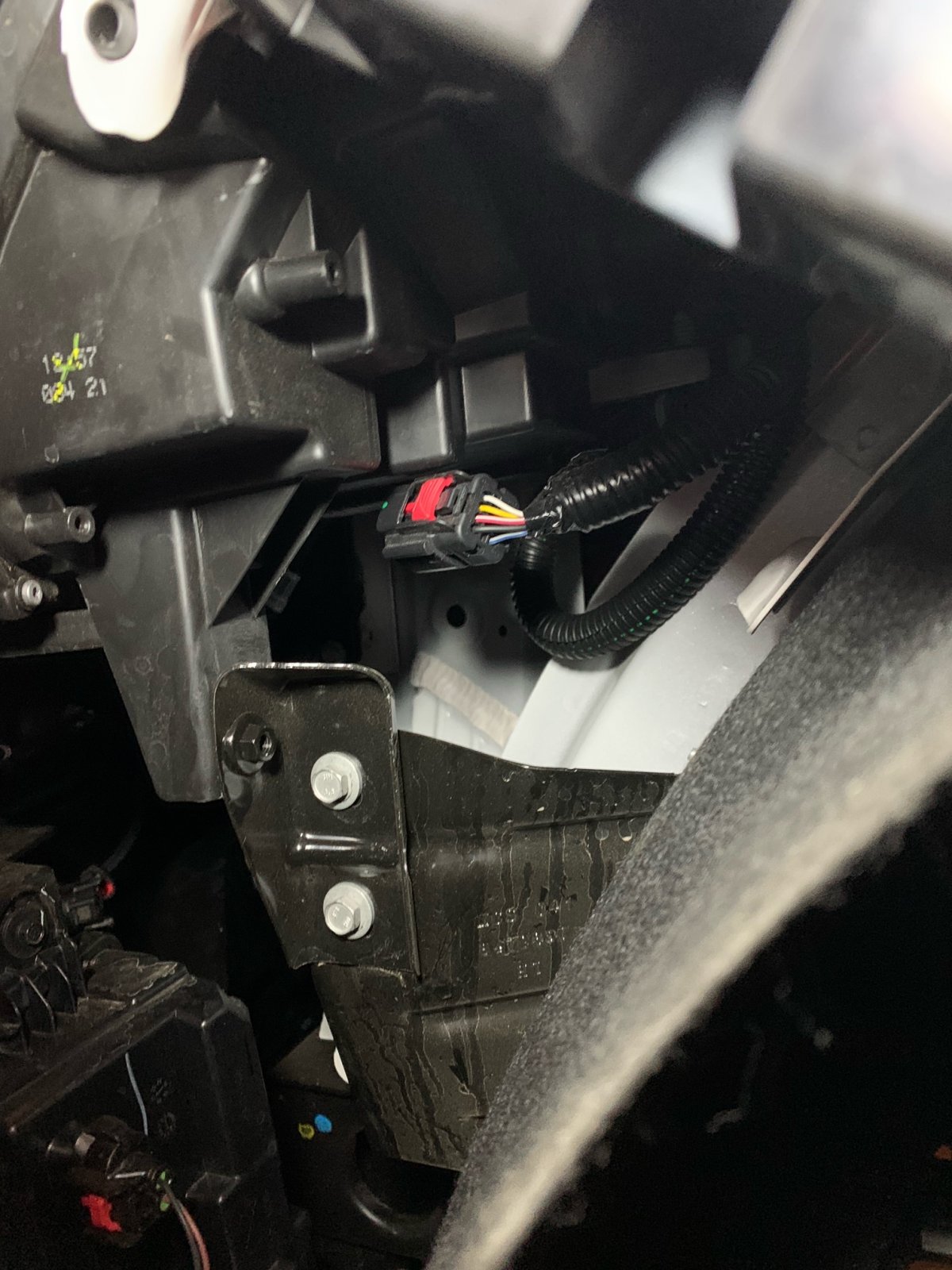

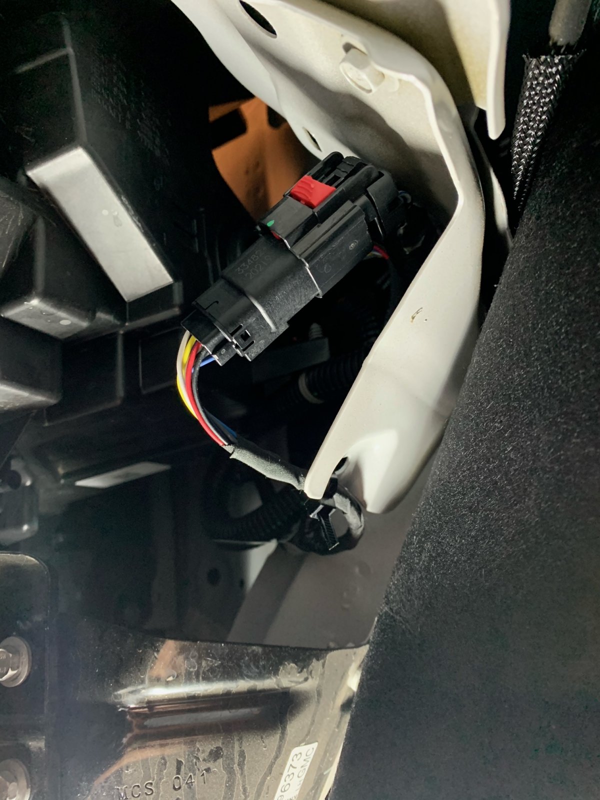

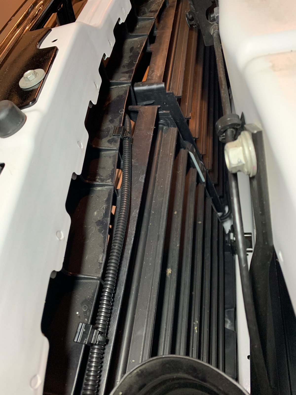

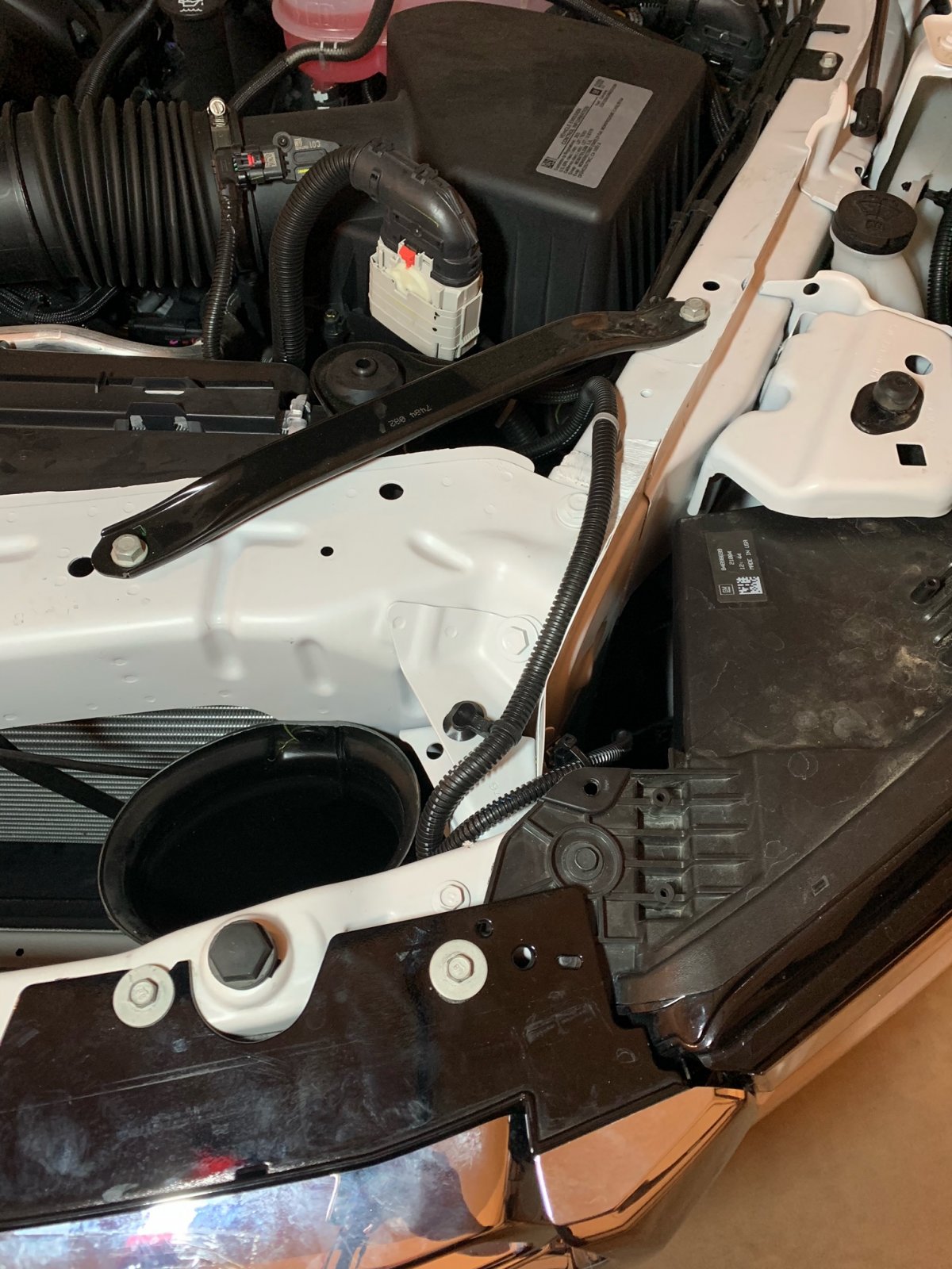

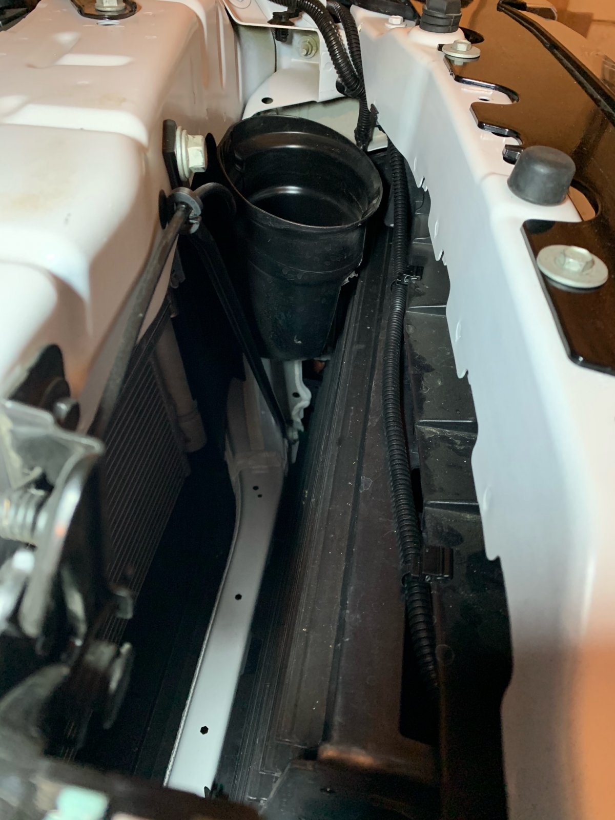

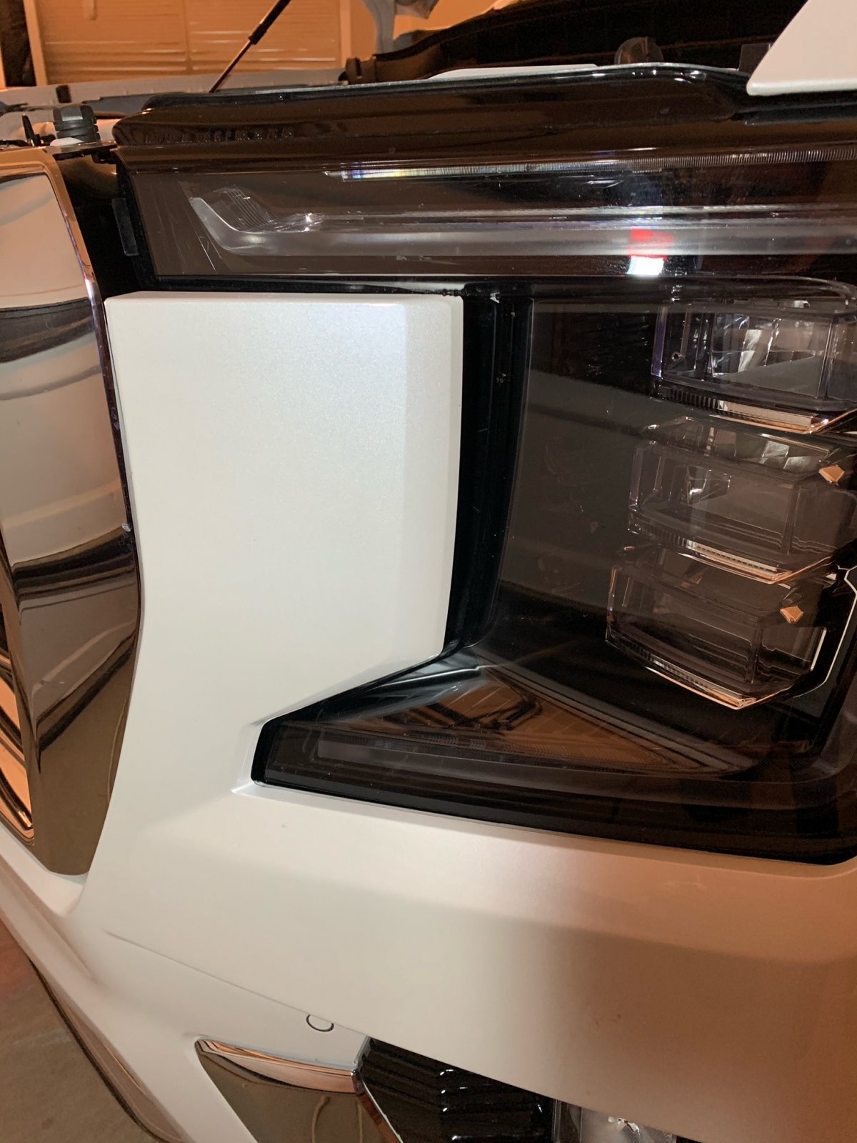

The wiring harness will plug into the new grille emblem and run along the shutter frame, down to the back of the left (drivers) side headlamp. The headlamps harness will plug into the new harness and the harness will plug into the headlamp.

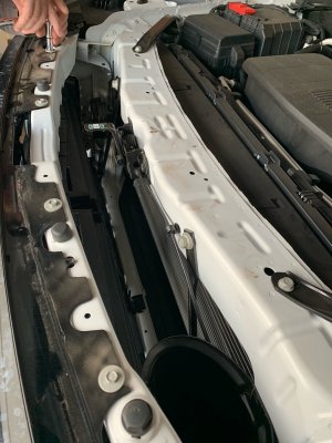

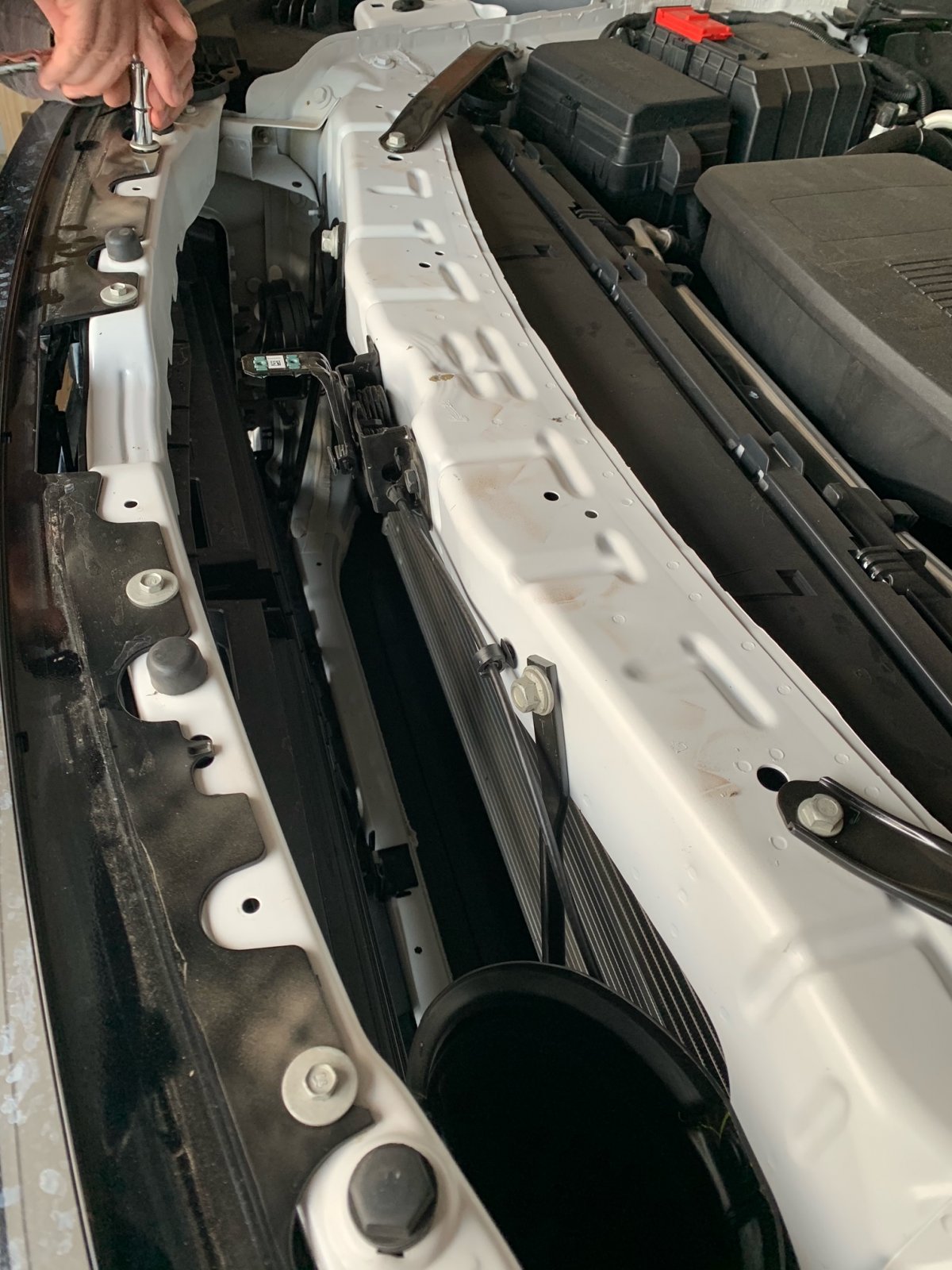

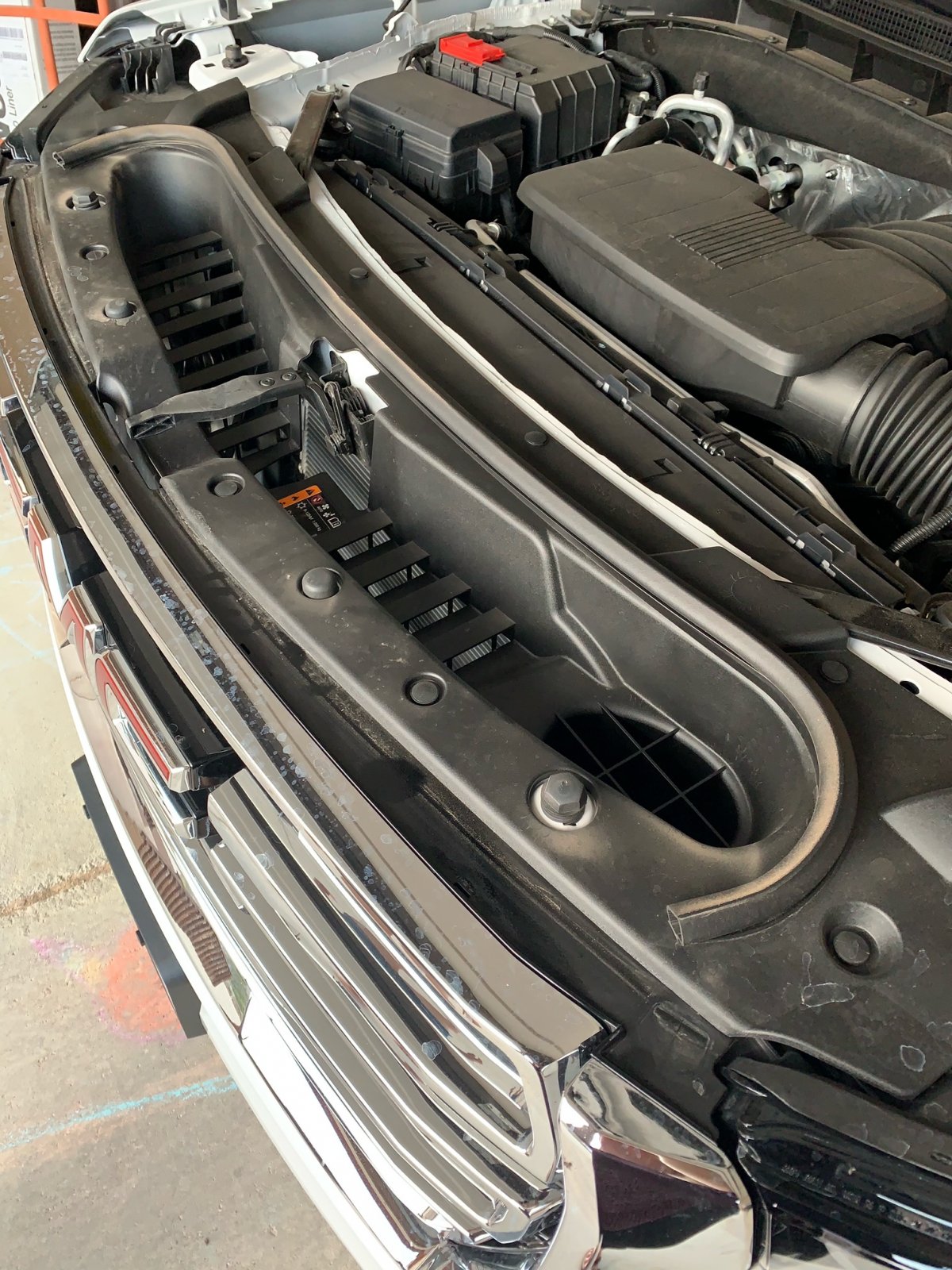

Remove the upper shroud. It is held on with plastic clips. Remove bolts on top of grille.

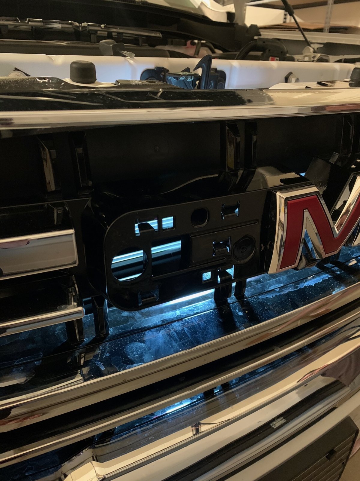

Grille has 4 tabs that need to be released after bolts are removed. One on either side and two towards the center. Pull up and out gently on grille. This will allow you to get behind the old grille emblems for removal.
