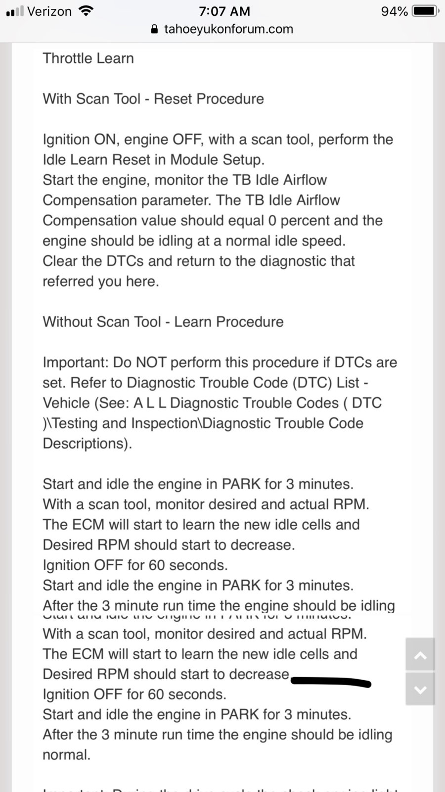

Im struggling with the decision of cleaning the throttle body given that I read somewhere that if you pull the throttle body and move the throttle plate while cleaning it that you must perform a idle relearn which requires a $1,000 plus scanner that has relearn capabilities.
I have never had to perform this on a GM vehicle in the past when I cleaned the throttle body, just pull the positive battery cable and after a 1/2 hour the PCM resets and all was well.
Anyone have the definitive answer? Do you have to actually move the throttle plate in order to need to perform the idle relearn, of is it not necessary at all?

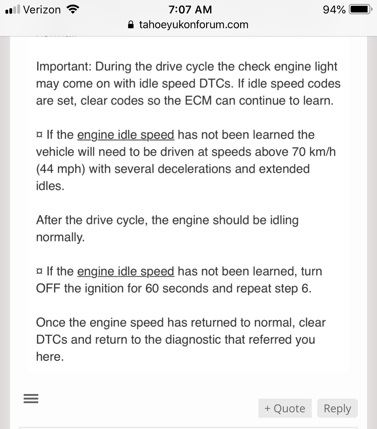

There is a relearn procedure. Iirc it’s something like start truck, do not touch gas pedal, idle for 5 min, shut it off, do same like 3 more times and it should be fine. Something like that, ive posted it a few times. If not I’ve heard it takes a few miles for it to settle in..but will get there. I did mine and grabbed everything, moved every, sprayed everthing, didnt give it a second thought, did the idle relearn procedure and had no problems. Eventually, no matter what, the truck will learn and right itself
