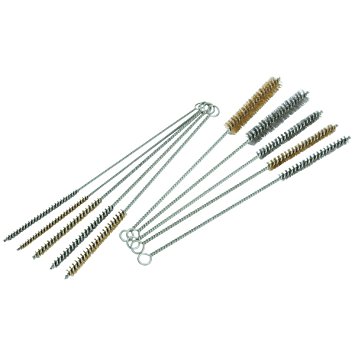

I clean the bolt holes with a wire brush whenever I replace something like a water pump. I did the same on my rear differential. I bought a pack of spiral wire brushes from Harbor Freight and I use those to clean up the threads on the bolt holes. I use some by hand but I also take a few and snip them in the middle of the "handle" with a pair of wire cutters and I then put the brush in a drill. A few spins with a drill and the bolt holes are all completely clean in about 5 seconds.

Good idea and hopefully you blow the holes out after you do the brush cleaning.

Yes, I forgot to mention that. But that should be a given that you need to blow the holes out with compressed air. If there is any rust or corrosion on the threads, I spray a bit of WD-40 in the hole before I hit it with the wire brush. Then I blow it out with air, and I hold a shop rag over the area so it doesn't blast dirty WD-40 everywhere, most of it gets caught in the rag.
