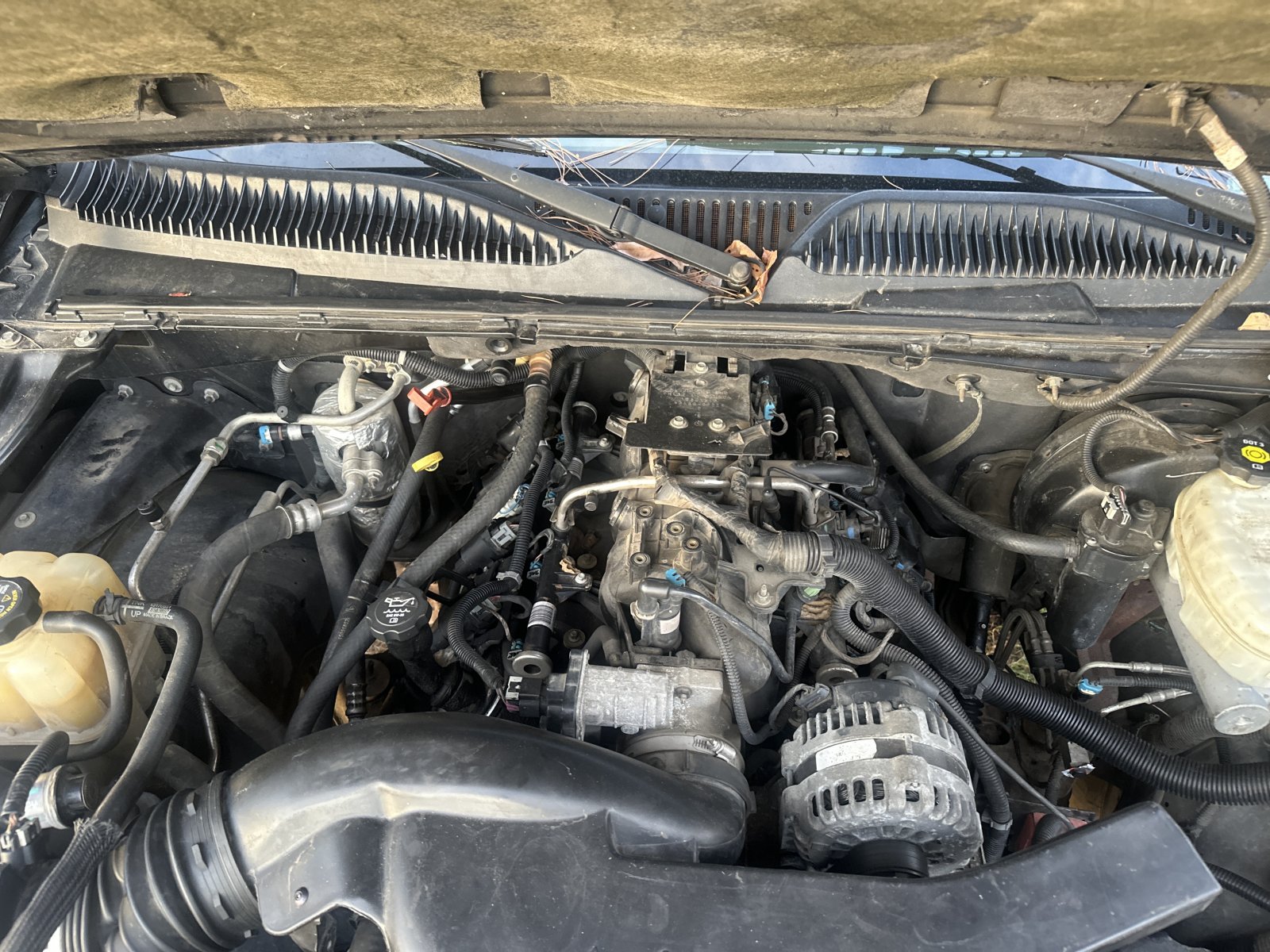

Welcome to the Forum from NH.
Pics of the truck, please.
You are already receiving clarifying questions and sage advice from the knowledgeable folks on this Forum.

Can anyone please help with the amount of diff, transfer and trans case fluid amounts I should put back into the truck?
Also I think a ground may have came loose because when cranking everything sounds fine and will fire up with starting fluid but not idle. No bad sound coming from engine and no metal in the oil.
