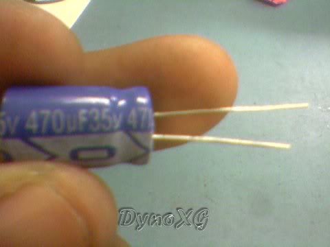

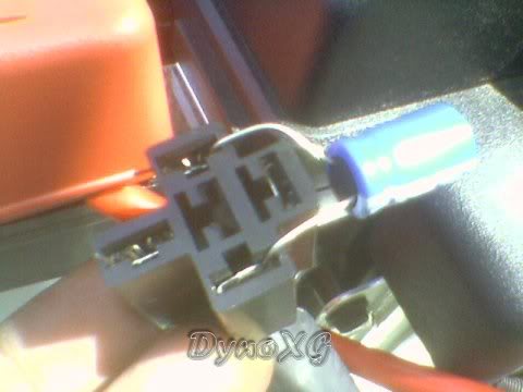

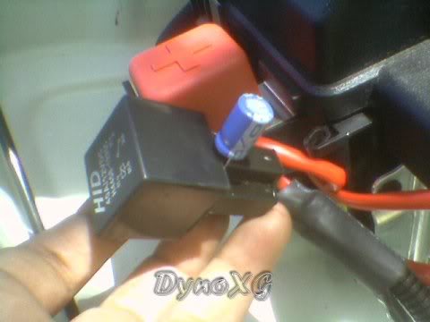

I would go and buy OEM, Matsushita, Phillips, Denso. To me, it cost alittle more, but OEM is the real deal. Only thing I will ever use again after buying 2 sets of PnP HID kits and both going out. I know alot of people haven't had problems with them, but OEM was made to last or they wouldn't put them on cars.
But I would redo your wiring, and possibly look into running all new wires and run to a manual switch. Also use this=
Pic of installed in connector for relay-
It is made to stop ANY n ALL flicker related problems. Best couple of bucks I could have ever spent to ensure safety of the HID equipment. Also, use a fuse EVERYWHERE!!! I added 2 extra fuses inbetween my ballasts and relay, and main wiring. Also, try not to have lights on when you turn the vehicle on. Just an extra percaution, shouldn't hurt to have lights on, but it's a just incase thing. Use smaller fuses!!!! If they call for 15 amp, use a 10 or 5 amp, just enough not to bust everytime, but better safe then sorry. Also, silicone the ballasts!!! Unless your using Matsushita's ballasts(which are potter)Most ballasts aren't potted, or made to be around water. Matsushita's are 95% water proof, just adding alittle silicone gives it 100% water proof. also, try to shield your relay kit from water ie/ waterproof it with something, tape or silicone. Take precautions
Now I know EAGLE will say it delays the turn on and turn off of the HID headlights, but it did not do this for my system, and from what I read on HID forums and sites, not what it's meant to do. EAGLE may know more then me regarding what this capacitor does. But from my system and what I've read, not what it did for my HID headlights, or others. It just stopped my flickering issue
