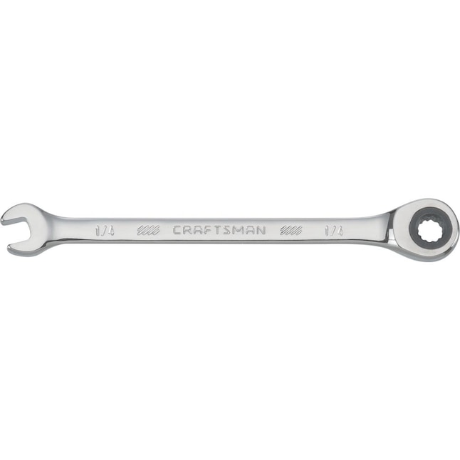

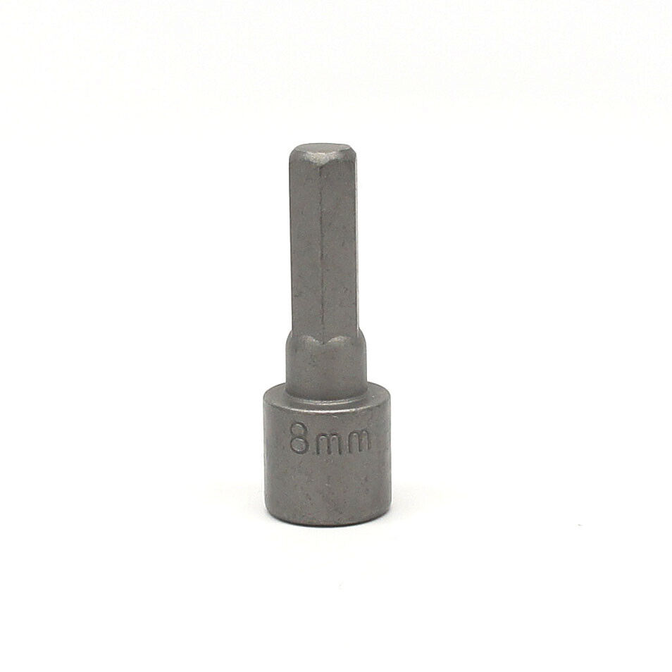

I don't recall if it was with the '800 or '900, but there's an actuator on top of the plenum (maybe the one in question?) that, with a few easy tricks, is replaceable without all the hassle outlined in the shop manual. I'm pretty sure I recall someone posting pics and describing how to do it. It might be something as minor as low headroom and a 7mm (or is it 8mm? I always use a 9/32") nut driver bit in a 1/4" box end ratchet is the trick.
One of these:
In something like this:
It makes for a really low-profile nut driver. I use such a setup at work for one specific task. I have a zip tie on the shank of the bit that extends through the ratchet wrench. I had planned on drilling the bit to press a roll pin through to lose the zip tie and make it even more low-profile. But I like being able to easily remove the bit as needed.
One of these:
the actuator bolts should all be 7mm, a couple are 5.5mm
Thanks. I can never remember. I just know the 9/32" socket works on the 7mm. It's a little loose, but them screws don't require a lot of torque. Now that I have factual numbers, I should add these specific sizes to my Tahoe-specific toolbox.
