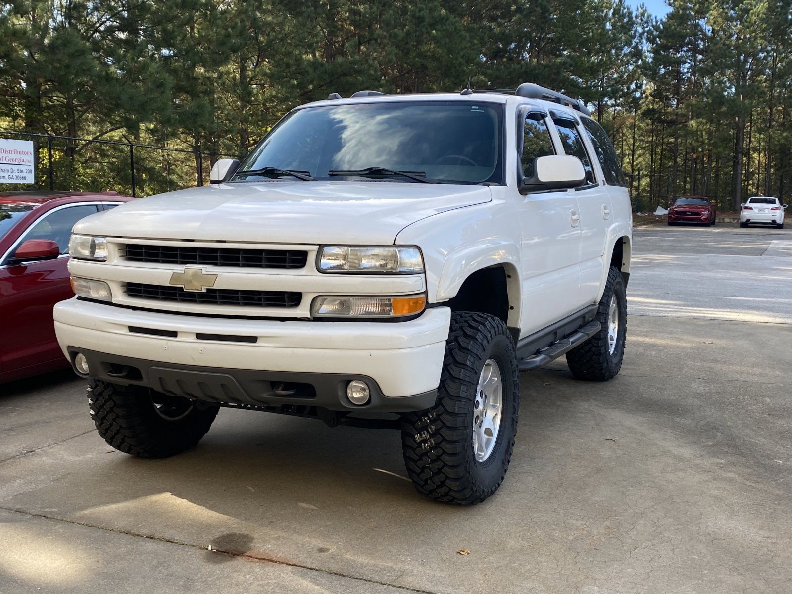

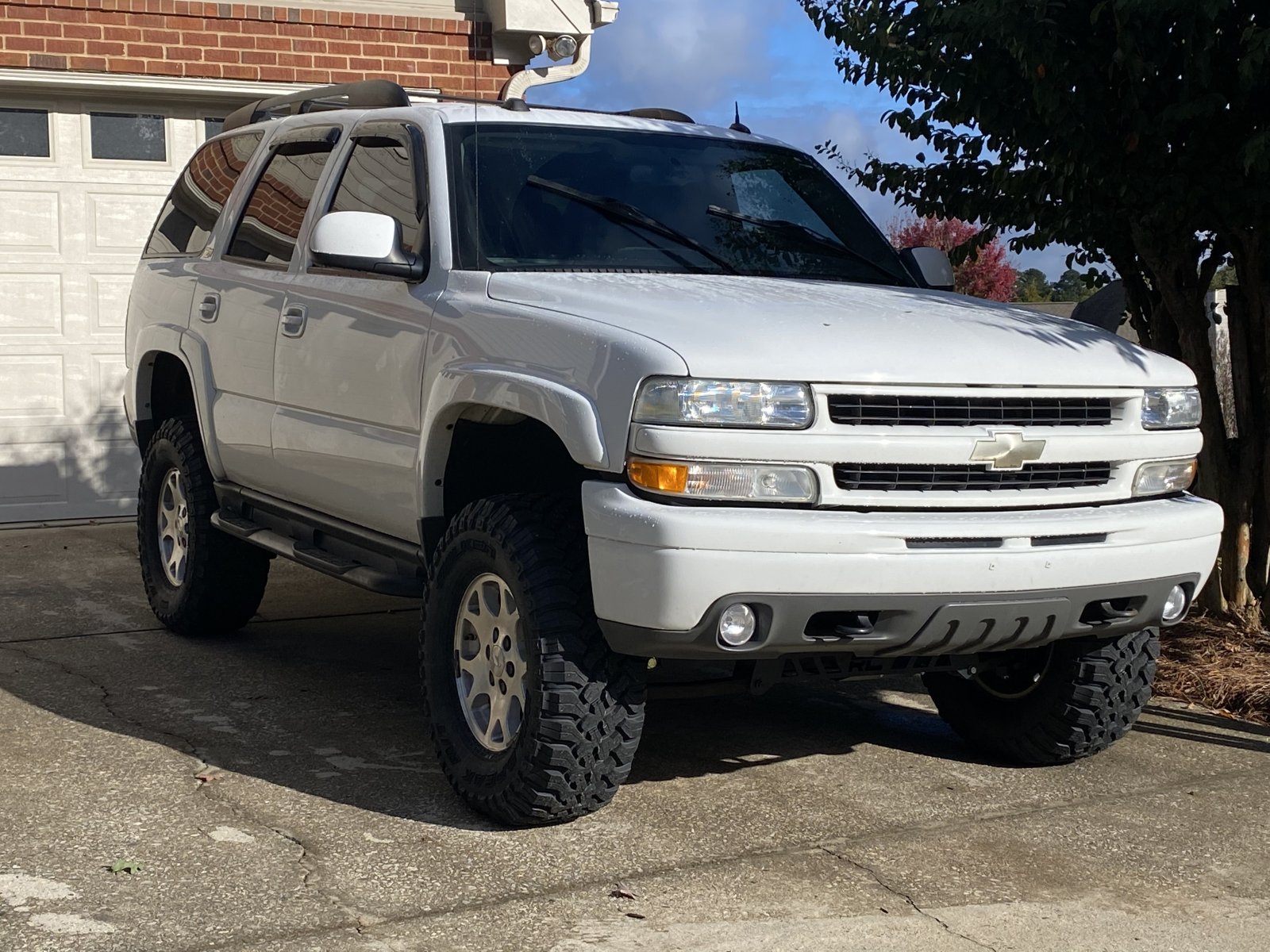

RC 6” lift & Falken 35-1250R17 MT’s
A bit bouncy, so I understand why people still need to upgrade shocks
I will get the longer travel rears and ditch the RC extension brackets
Had to use .25 spacers to clear front UCA’s

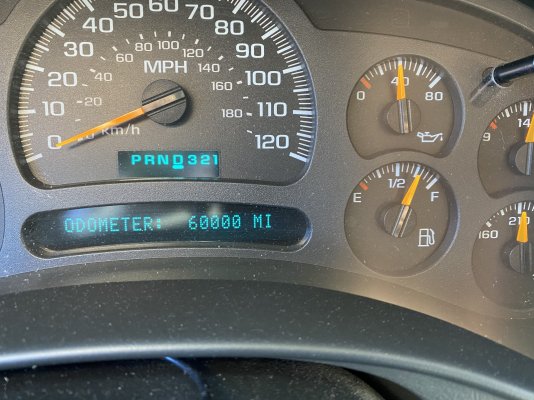

Rolled 6Ok yesterday
