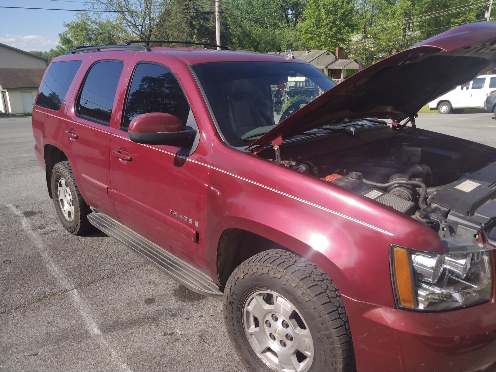

Hello everyone, I'm mainly here on a good friend of mines behalf. She bought a 2007 Tahoe off a local guy. Her Tahoe is having all kinds of issues. From a misfire (working on that as we speak) to the cargo hatch not working at all....plus other issues. So when the need rises I appreciate any input or insight you folks can share with me. I'm just trying to help fix it for her bc she's a single mom.
