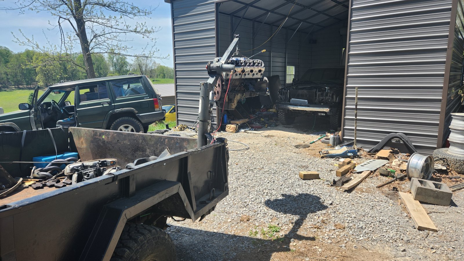

Oh, and here's a shot of my "cherry picker". Y'all working without a level shop floor, here's the ticket.

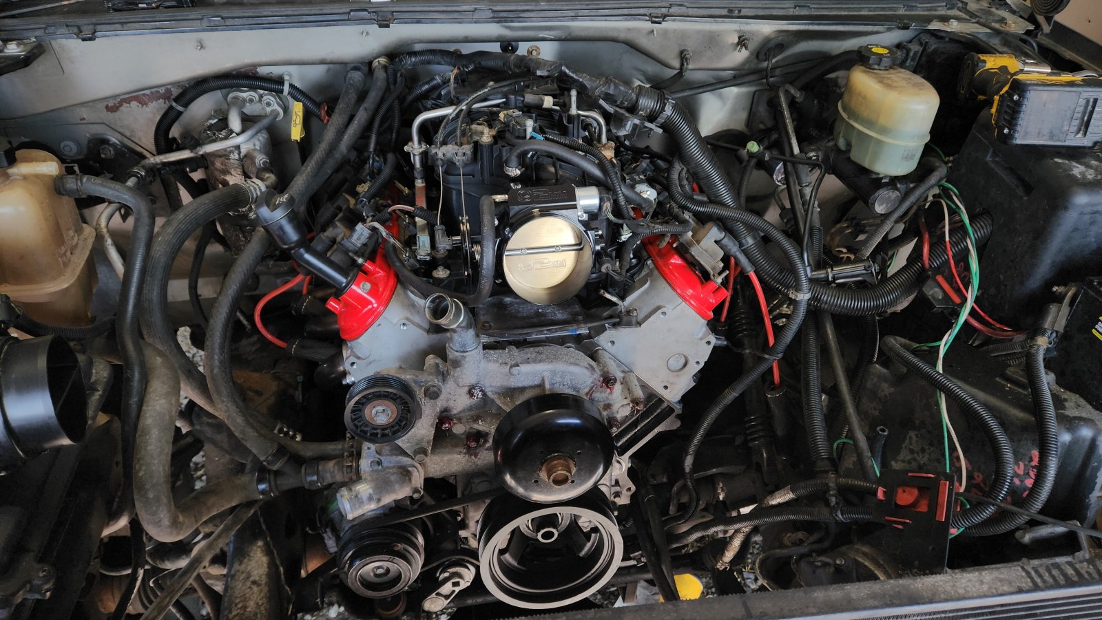

Last update - she's in and running. Went ahead and did the TBSS intake with a 92mm throttle body while I had it apart again. Still some tuning to do, but I'm very happy.
Did have a heart attack moment when I first started it. Only read 25# of oil pressure. I had replaced the sending unit, broke the original getting the motor back in. Pulled the one off the Tahoe and stuck it in, showed 55psi. Whoo!
Motor is happy so far.

I love the engine hoist trailer rig! It has a giant drain pan built-in already!
You may be humble on what you have for shop and equipment set-up, but I'll tell you I am green with envy!!
A welder AND a roof overhead? My idea of heaven...

I tell you, both welder and roof are complete game changers. Especially the welder - well worth the $175 or so to get started. Pays back 100 times over.
The garage belongs to my folks. I do a lot of maintenance for them and get free use in return. Filled a giant hole that was left when I left doing full time mechanic work. Recently asked me about pouring concrete.... Said he'd buy the materials if I'd do the work. Time to brush up on concrete skills!
