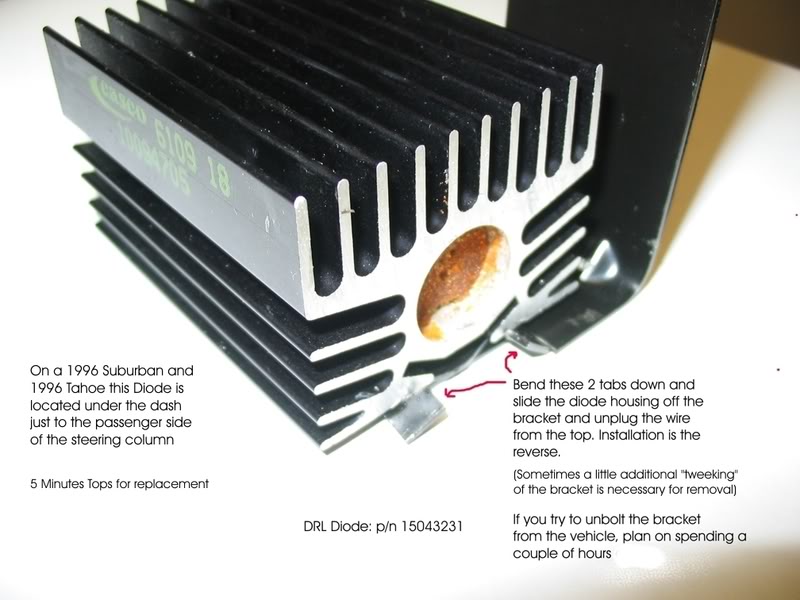

It took me 4 minutes to pull that diode and 2 of that was me getting comfy on the floor with the pliers and flash light.
That versus pulling the fuse (and I wasn't 100% sure if DRL was isolated or something else shared that circuit) I'd rather have one less piece of garbage under the instrument panel.
