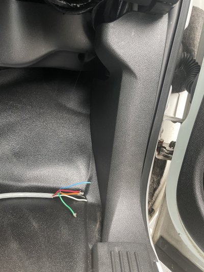

Looks like i wires go down towards floor. I think I have to remove flooring to see where it goes. 6CCC1113-C767-4F0F-9366-52554F8368E8.jpegAny idea if there is a wire connection point in the front passenger side?
Looks like I have to remove this plastic vertical piece too

All that Trim pops off super easy unless someone used self tappers, My guess all those wires runs to the back area or up the A pillars to the roof for lights and etc.
