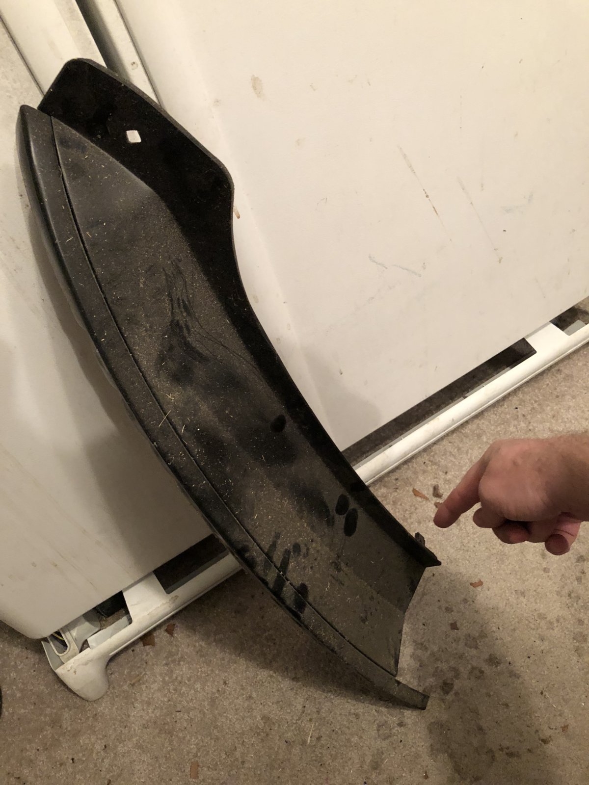

heres a picture might help. I’m pointing to the only actual clip holding them in there if you removed the screw already.
Fosscore
Apr 16, 2014
10,859
19,724
I know these are the Escalade vent caps/appliques, but I remember there being 3 tabs to pull out. They are not straight, but sort of wavy, which is what holds them in place, once that top screw/bolt is removed under the top of the liftgate. Have to pull them straight out, not at an angle. They will groan and creak and sound like you are going to break something, but seriously after a bit of wiggle and pulling, they should come out. There is nothing else holding them in place, just those 3 sets of bent plastic tabs compressed behind the window and body.

got them off the driver side broke into several pieces. Apparently the the back glass seal was holding four of the shorter tabs. The broke as well and remained stuck behind the glass. After some work i got the esky caps on.

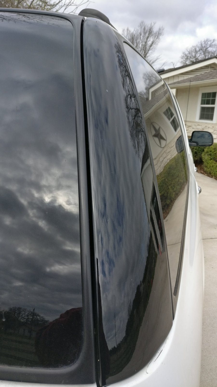

On a local recommendation I ordered these vent caps:
http://www.stylintrucks.com/parts/smooth_rear_pillar_vent_cap_cover/808.aspx
I had a local body shop sand, paint, and install them. The charge for this was just shy of $400 for 3.6 hours of work and 3.0 units of paint.
The caps were a little loose when installed. Upon my request, the body shop secured them in place with RTV sealant.
I went with black, since that's what the newer Denalis use for these caps.
View attachment 194572 View attachment 194573
So these go on top of your existing vents?
05Single
afraid of the dark
Feb 26, 2015
8,243
11,639
They replace the covers. But has smooth face instead of any type of vents. I seen 1 set in person on a tahoe and I was talking to the owner, was gonna swap with my escalade vents but his didn't fit well at all so I said nah.
