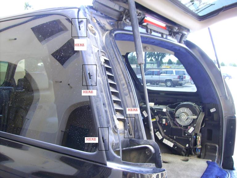

Anyone know how to remove the rear vent cap appliques off a 2001 tahoe. I know you have to remove the screw up top, and there are three tabs holding it to the body, but how do you remove the tabs. any help would be great. thanks

i have only found one screw, on the top, and looking at it, three tabs holding it on the side. i appreciate the help, sik whip by the way

Be careful as there are some sharp edges on the back side of those monkeys, just pull them away from the body after you remove the screws

heres a heads up...when you go to pull them off...it feels like they arent budging...use some force...your not gonna break it!
