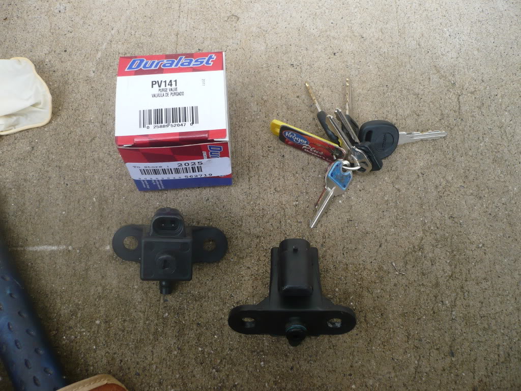

Here is what the part looks like (you can see the old one next to the new one).
http://i191.photobucket.com/albums/z315/95gatl/P1030684.jpg
