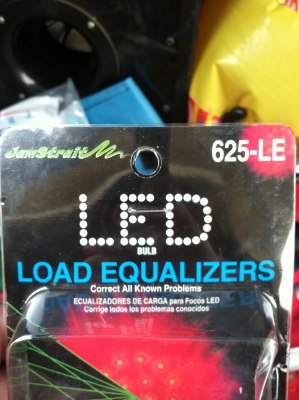

Soooo the fix is load resisters, got a pair at AutoZone for $12.99. You can get these at electronic shops also you need 10 ohm 25 watt load resisters. My favorite electronic shop was out, so next more expensive was AutoZone.
These will be installed between the ground which is the Black wire and the Blue wire which is the positive switched by the brake pedal. Both sides need to be done and both sides they are the outside wires. Make sure you are dealing with the connector that has the 3 wires not the 2 wires. 3 wires is the brake light connection.
These get hot like a 25 watt light bulb so you want to make sure the resister is 1" away from other wires. It may not melt them but it may char them from heat over time causing them to break.
