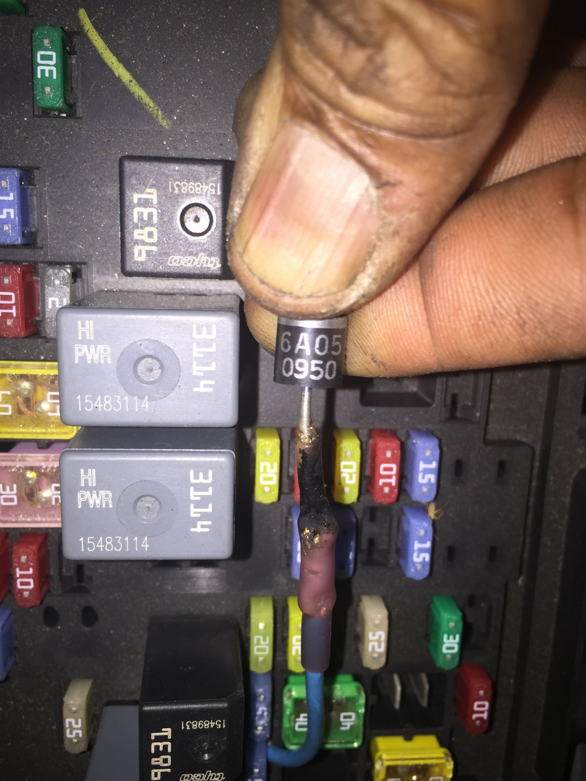

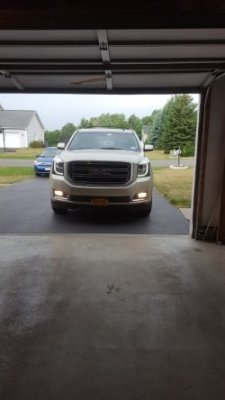

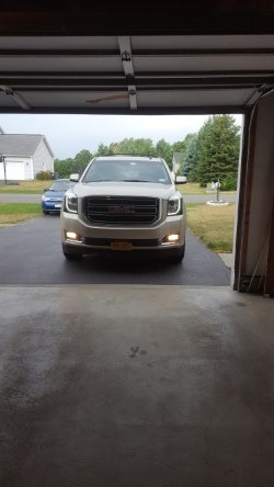

heres a simple way to make drl come on at night or anytime park lights are on with out the need for fogs.
Take a diode and point it from the parking light fuse towards the drl fuse. This way the drl will only come one when park light is on. If it's pointing the opposite or no diode is used, any time the drl is on, it will make your running lights come on too.

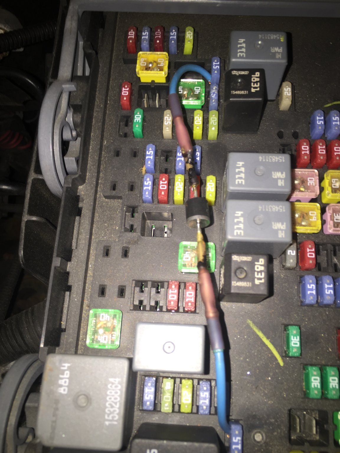

I took shrink terminal connectors and attached them to each leg of the diode. I put wires in the other side of the connectors, strip the ends and wrapped it around one leg of the drl fuse 15amp #31 and used right park 15amp fuse #27
Diode I used is from radio shack 6A050960. The silver strip represents the way it allowes current to flow so make sure that's pointing towards the drl fuse.

is that diode getting too hot or was that just burned from you melting the heat shrink?

No that's from me using a butane lighter to melt the heatshrink, got a little too close and used more that I needed too

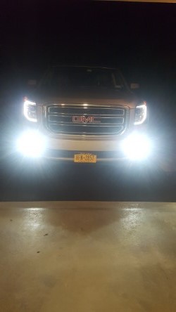

Excellent write up! I will be doing this soon! I have halos and leds tied into my running/parking lights and I want the halos to come on @ night with my headlights.
