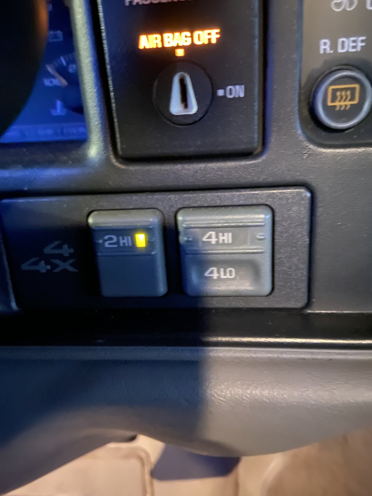

Owner's manual says there should be an indicator light on the 2W/4D switch panel. I don't see one. I opened it up and see lamps, but there is a mix of LED and Incandescent. I'm guessing the Incandescents are illumination/backlighting and the LEDs are the indicators. But if they don't work to show drive mode, where is the problem?
No, I haven't tried to change to 4W yet. Remember, I've only had this a coupe of weeks. I kind of don't want to try it if there might be a problem.
Main questions being ...
If there are no indicators, how do I know which mode it's in?
If there are no indicators, is something else not working?
