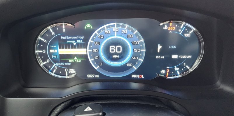

Even with the DOD delete kit, cam, and turbo setup, I'm happy to see the Escalade is getting 18mpg on the highway which is actually better gas mileage than my 5.3 Silverado with a 6" lift and 35" tires....
