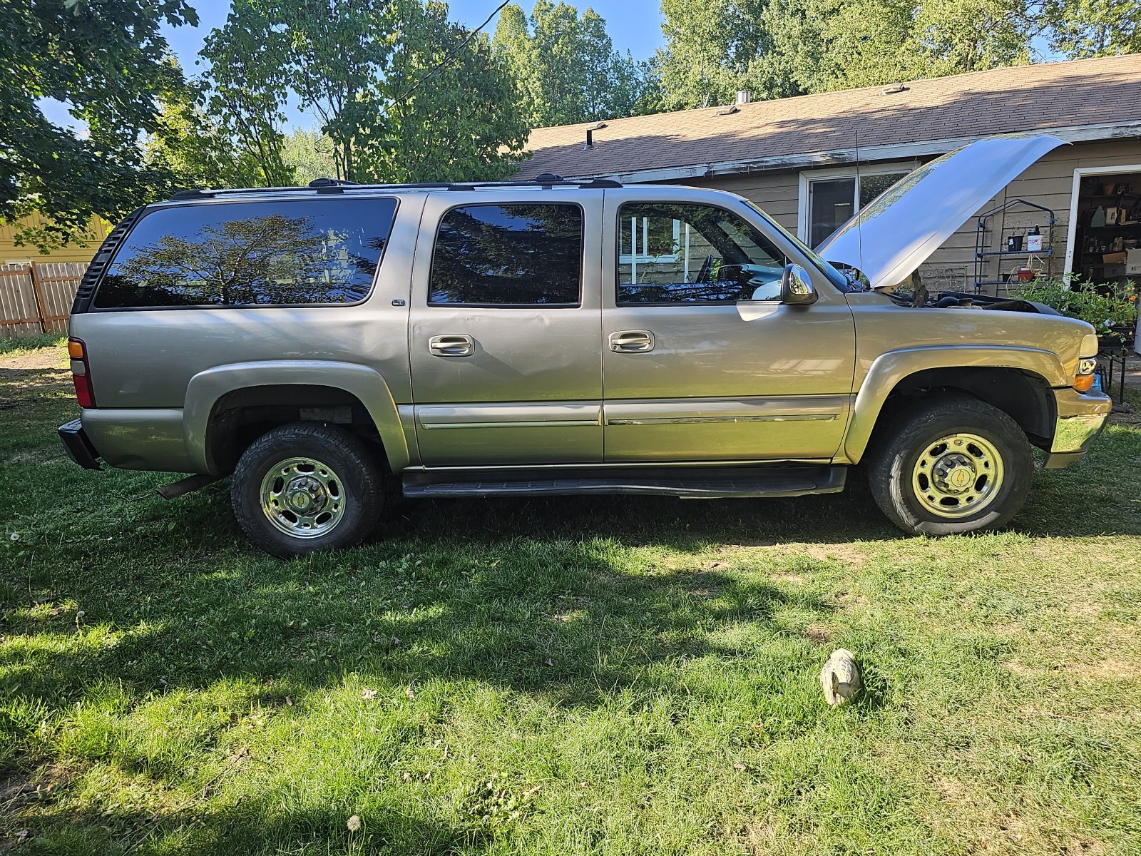

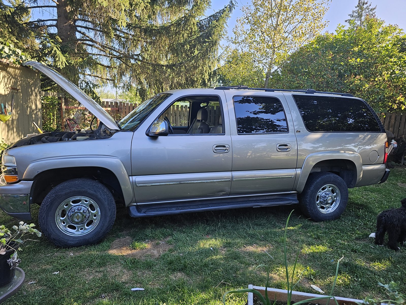

Went out today and i had a low tire. So yeah i just went and got a new set.
This how it looks now with new tires and no running boards.
I need to crank the front end a couple turns to level it out some. Just seems to low in the front on level ground.

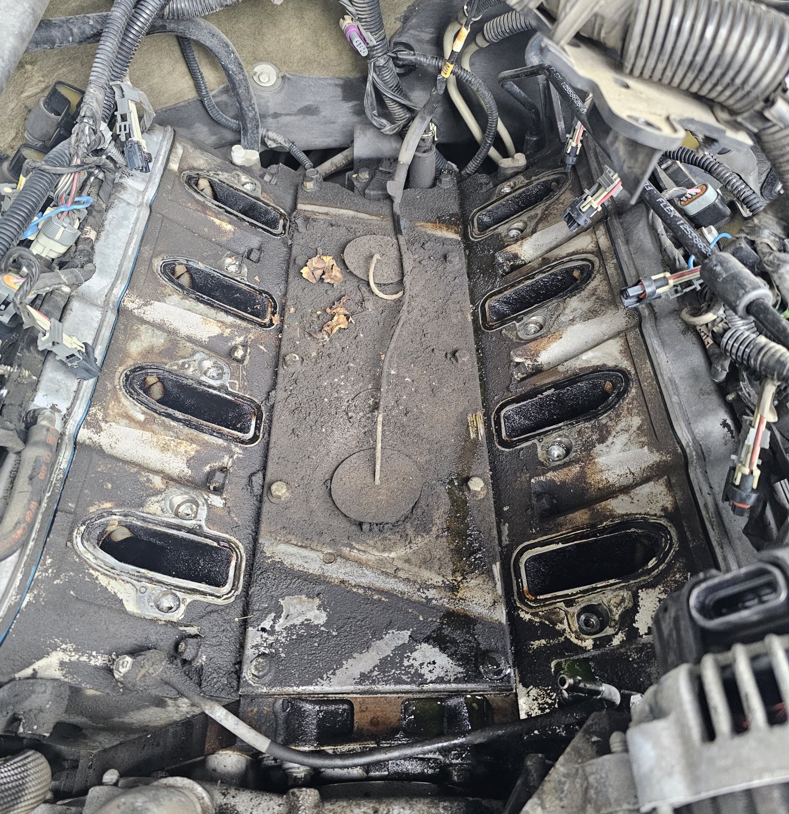

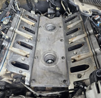

Tackled the Knock sensors today and all was pretty normal for the most part.
I did find both knock sensor rubber caps were popped out of the hole and were sealing nothing. Also rock hard.
Found the rear knock sensor hole full of what looked like fresh water. I assume from when i washed the engine off best i could.
SpareParts
SpareParts
Sep 17, 2023
65
81
North Idaho

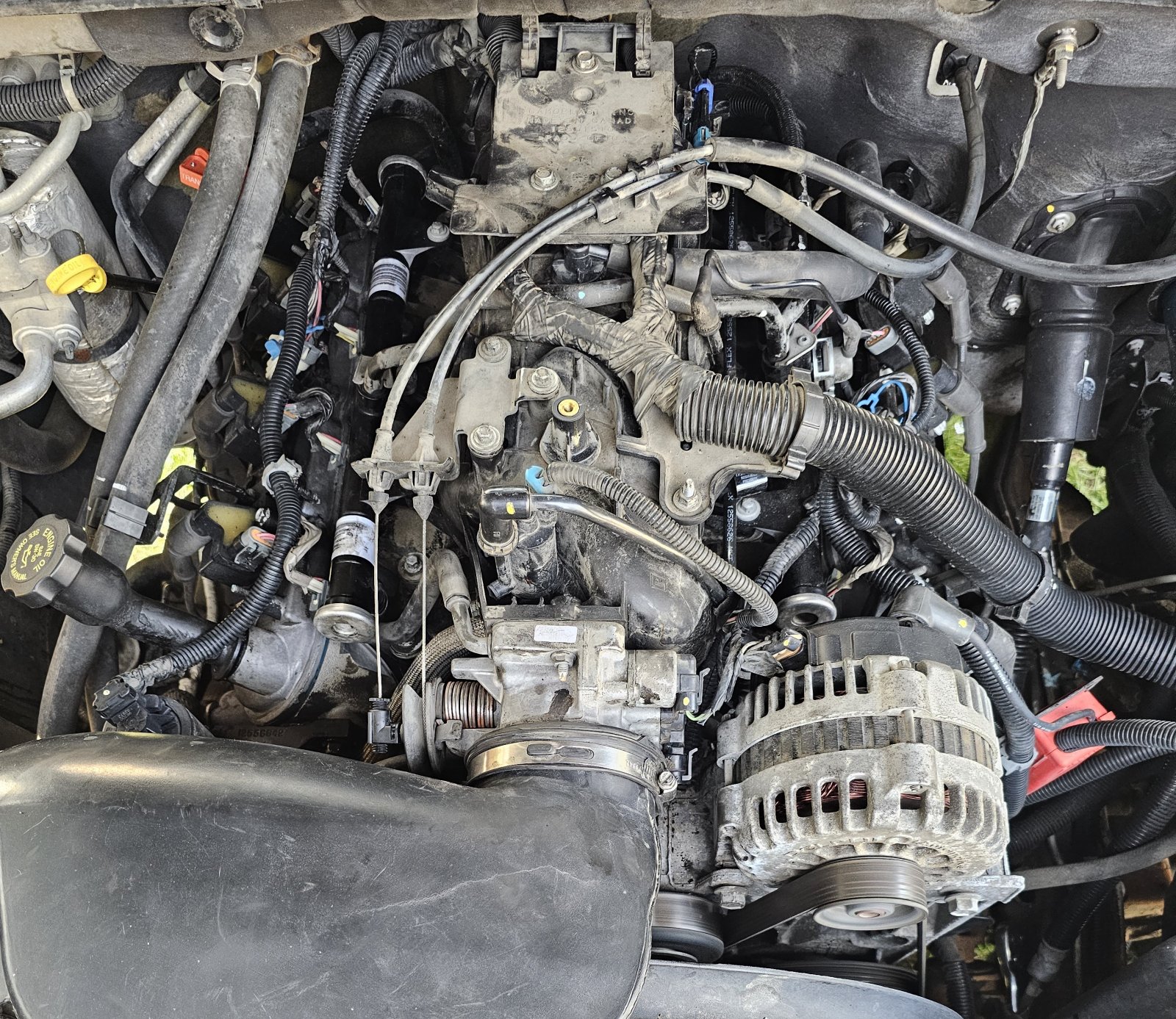

It took awhile to clean it up enough to put it back together. Intake manifold is nasty on the inside and i did not clean it out much as i could not figure out a good way to do it.
It's back together and running now though. Thinking of ordering a new intake but i guess first i need to fix the exhaust manifold leaks.
Did not get a chance to drive it but tomorrow i sure will! Gonna be pi**ed if the Knock sensors give a code now.
