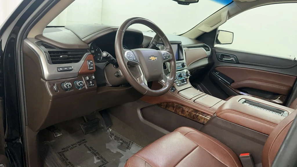

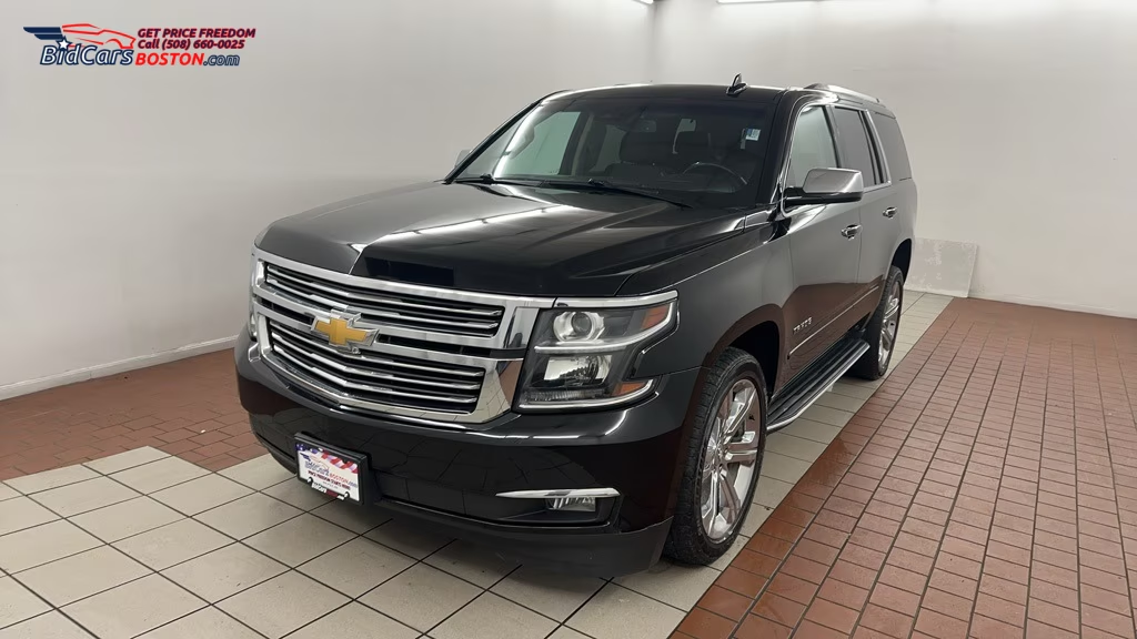

Looking for a little input guys. So i owned an Avalanche that i bought brand new in 05 for 13 years and got 385000 miles out of it in 13 years downsized to a 2014 Durango Citadel in 2018 and I'm ready to go back. Found this bad boy for sale asking 28.500 its a 2018 Tahoe premier with 98000 mile. Been doing vin checks and any and all research i can on this vehicle. Viewed it once in person but they wouldn't let me test drive because they said it was on hold. I guess it didn't sell. Truck looks great inside and out just wondering what i should look for when i go test drive it. the one thing that scares me it the dealer ship reviews itself they are not good at all. But i can also be a salesman's worst nightmare. I am hoping to bring a mechanic with me when i test drive it as its about 45 minutes from my home and I'm sure they wont let me take it to him. What advice have you all got for me before buying. TIA
