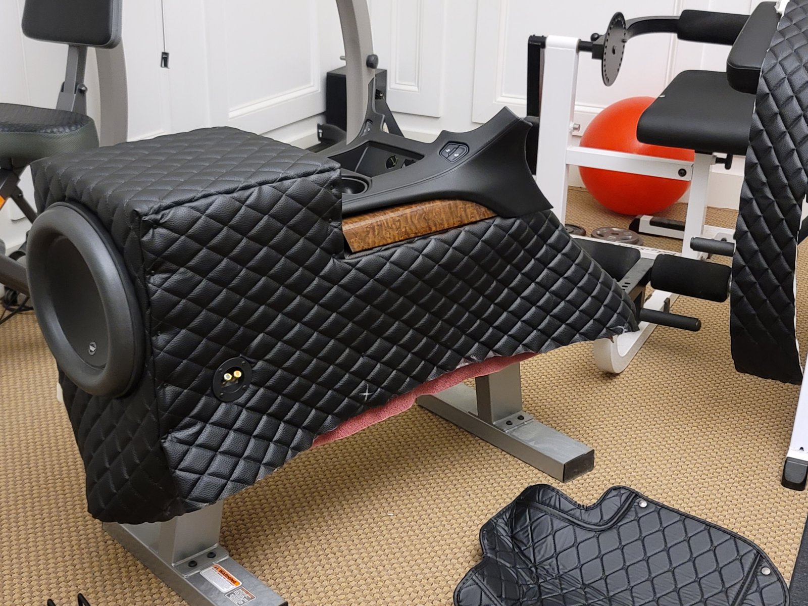

That is the center console I built for it. I have the phoenix 12.1 screen in it as well. And that all works well. I'm getting ready to install the 360 degree camera in it and wanted to fix the issue of the interior lighting not coming on with the doors opening.
