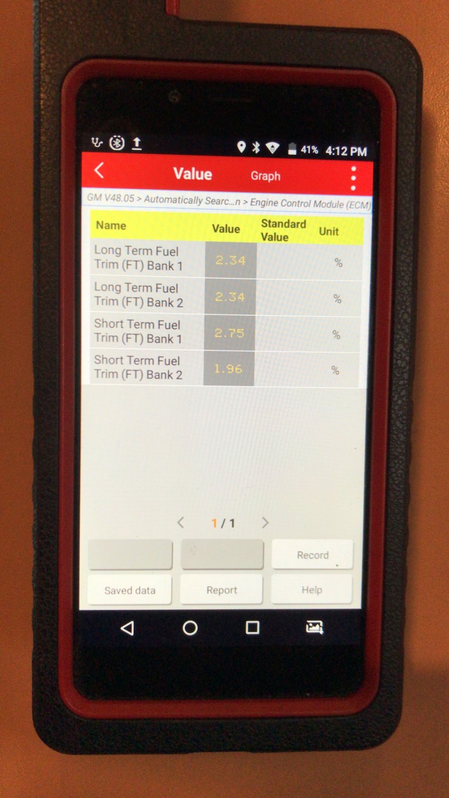

Intake manifold removed today, found this sealed plastic nipple (somebody here will know the name) broken off close to the fuel rail.... Guess I caught it or leaned on it when replacing the pressure sensor and busted it.
Capped it off and it's running normal again. Fuel trims back to how they should be.
